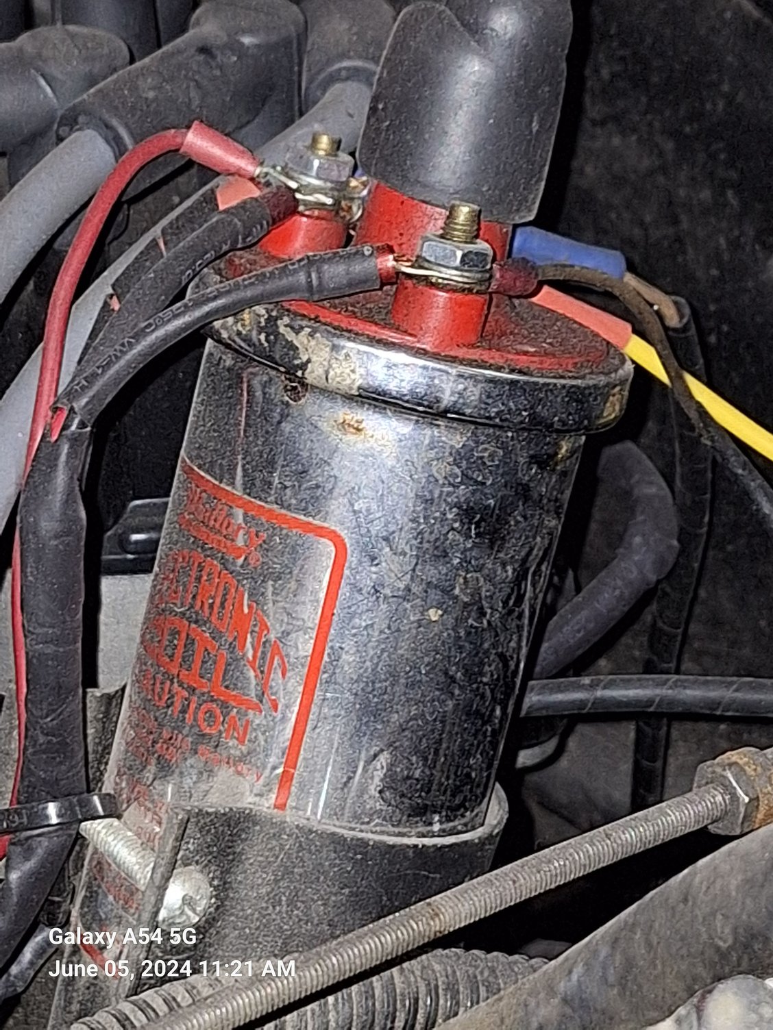

Well after a few hours of fun and misery (100 degrees around here these days) I was able to make the 67 run and even drive it home - vintage AC working perfectly! I repaired the Unilite and got it installed including the ballast resistor and diode wire from the starter and...no joy. I was thinking on what to try next and found an older Bosch coil laying around. I had used it to ohm test it to compare the numbers to others. I decided to give it a go and the car started right up. Bad Mallory coil 29219 - that's a 1st for me. It's running better than in quite awhile. The distributor that I removed was one of those A Team distributors (not installed by me) and it must be ok. I'll save as a spare. Thank you for the ideas!
