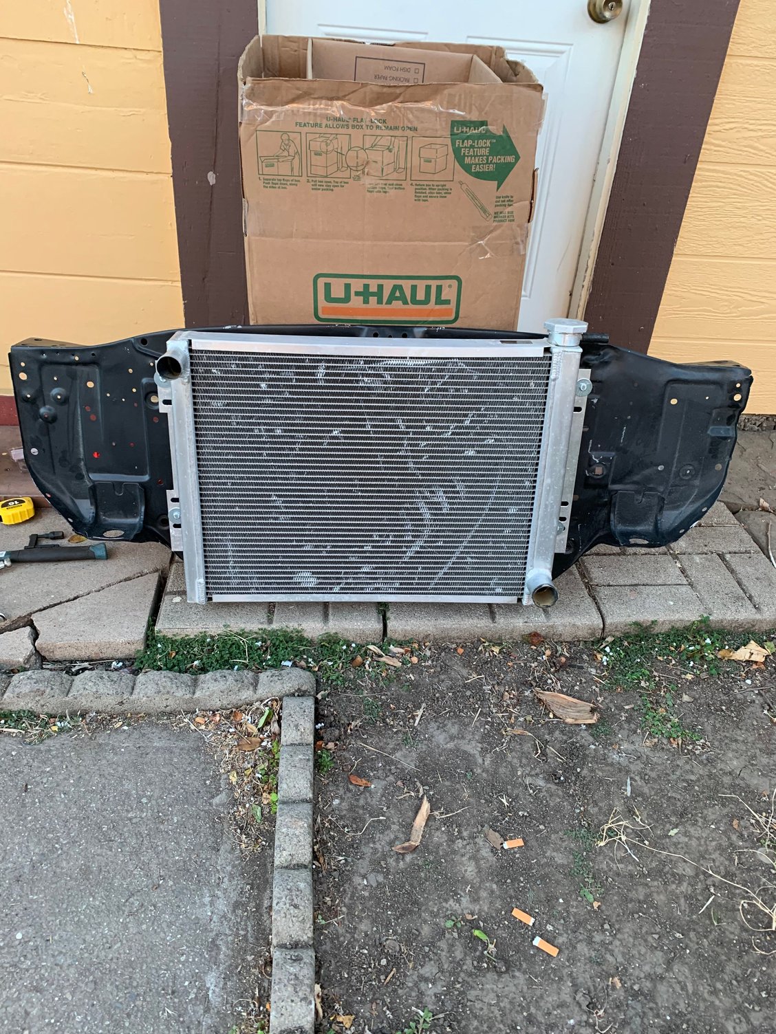

I just installed a 70’s Nova radiator on my 69. Question is, is the radiator cap suppose to be over the support or level with the support?
You see how the cap is above the radiator. Is that ok?

on my 68 it is above the support

1968-72 Nova`s are the same .Thats an aftermarket radiator so its different from a stock "Modine" type of radiator of which are tilted.
Old Jun 8, 2019 | 09:37 AM
As long as the hood closes, it doesn't matter. I wouldn't attach that radiator permanently in place on the core support until it's mounted on the car, your hood might be in the way by how it looks. My radiator cap is about even with the highest point (middle) of the support, but I don't have a hood on for clearance reference.

Yeah, that’s what I’m worrying about is the good closing on it. And it’s bolted and not welded in place. Just I already drilled 1/2 holes.
