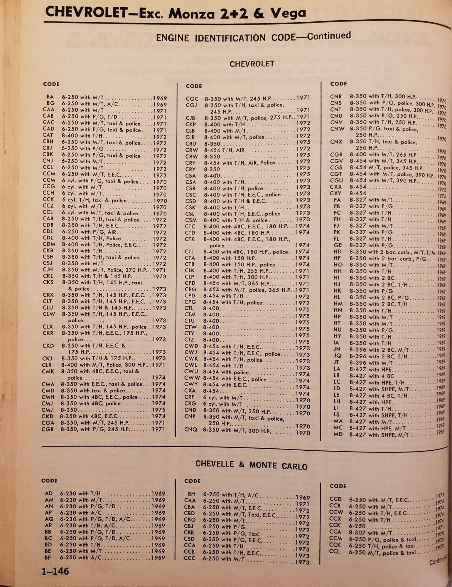

The engine code is the suffix after those vin numbers you posted
You need a 1975 book like this 1978
It will go back to 70 maybe but you will need the suffix of the 2 or 3 letters after the numbers Here is the earliest page that my 78 book has for Chevrolet

Okay, here you go if you found the engine suffix off your block
Here is the old book I have and a few of its pages
