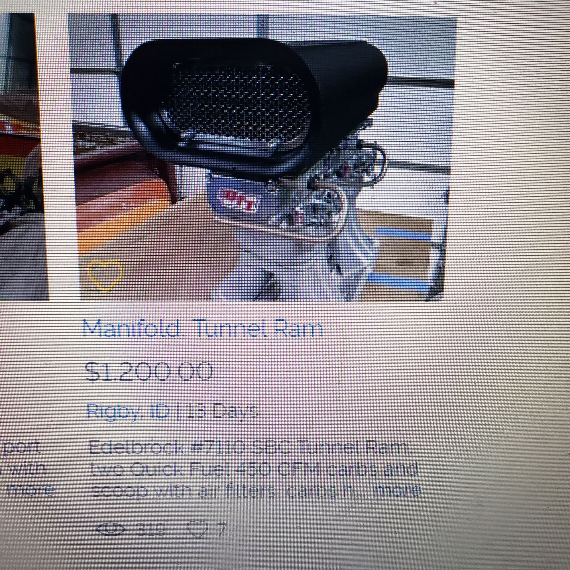

This is the only tunnel ram currently for sale around here for a SBC
This one also seems a bit expensive, but with the carbs and extras, maybe not that bad of a deal
Ad on ksl.com/classifieds

Would you share where I can find that? Like to see if they would split it up, as I am thinking of larger carbs. Plus I would like to see a clearer pic.
