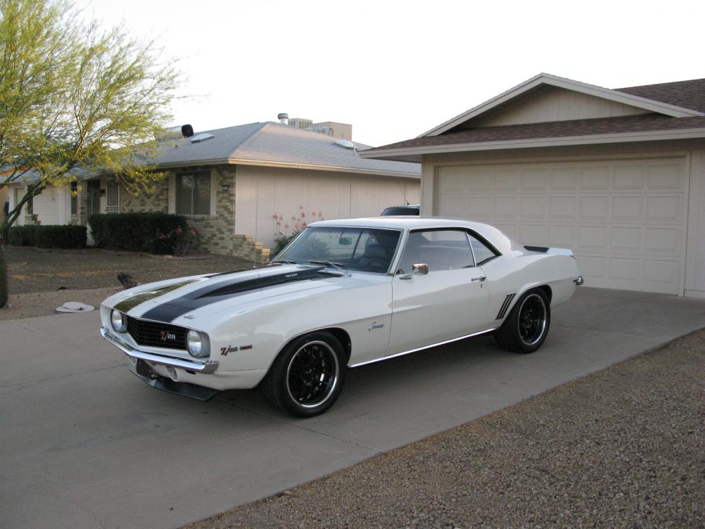

Any advise, tools needed? is it easier to remove the pump?
Thanks
Robert
