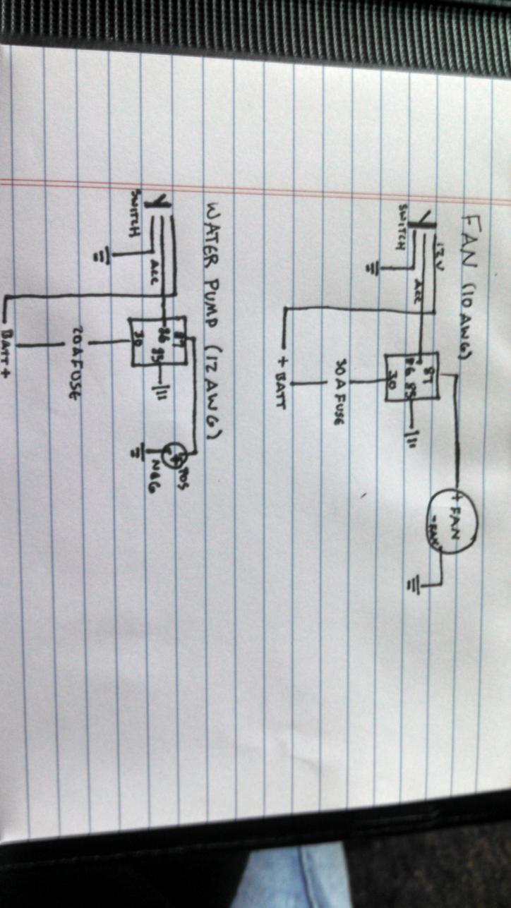

I'm installing a switch panel for my electric fan, water pump, and fuel pump and just need to make sure this is right. This is my first time installing one of these but I think it's about right. Only thing I was wondering was if I had the inline fuse in the right spot.
I didn't draw the fuel pump but it will be the same as my water pump.
Thanks!

Just some more info: its a Spal 16" fan, CSI 55 GPH water pump, and a holley blue fuel pump. The switch panel is toggle switches.

Looks ok to me. I don't think you need the grounds at the switches. Fuses are in a good location.

Well normally that would be the case but these are LED switches. I appreciate the reply.

Here is something you might want to think about adding to your fan circuit, a thermostatic switch. This way you are protected that if you forget to turn it on the toggle switch.
I have mine wired so that it comes on automatically or manually.
