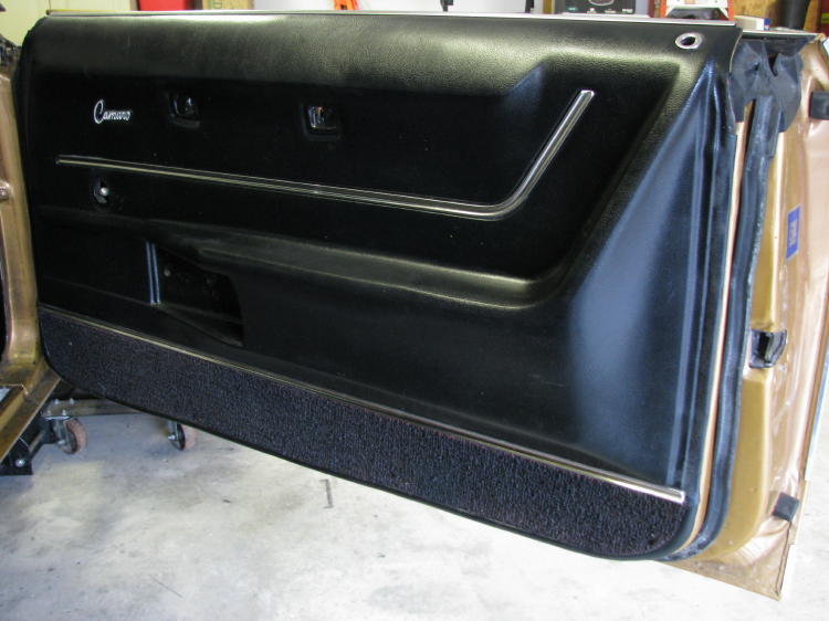

ok, after alot of trial and error and much consideration... I think I am going to let the Deluxe Door Panels go. they look great but I had no idea that there would be so many differences in the mechanics of the door.
First the Door Lock Bell cranks are in the wrong place so I would have to drill new holes in the top of the doors then try to Fabricate a new rod (or buy a whole new setup).
Second, the Shaft on the Window Regulators is too short. I have come up with a way to try and make it work with aftermarket crank handles but its gonna be another trial and error deal. or buy new regulators and change them out. this includes the rear regulators too. $$$$
Third, the door opening mechanism is "pull", not "lift". so new mechanism and new pull handles are in order. there again more $$$
so, Im gonna order new pre-assembled standard door panels, front and rear... all I will have to do is install them. kinda bummed about it but it is what it is. anybody got deluxe door panels in bad shape that are interested in mine send me a PM.

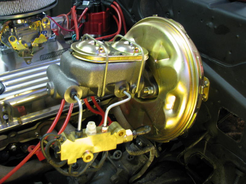

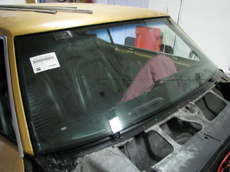

been busy the last couple days... Finally got the windshield installed. and the Brake Pedal, Brake Booster/Master Cylinder, proportioning valve all hooked up. also got a new Billet Pulley on the Power Steering Pump (sorry forgot to take a pic) and got it installed with the new lines.
the windshield is a big deal for me because it was the first thing I removed back in Nov 2007.
Mah S**t is gold plated Yo! lol, I have no idea why it looks like that, its not nearly that gold in person.
Ive gotten a few other things done too... more pics to follow. also decided to keep my Deluxe Door Panels. Came up with a way to make them work.
