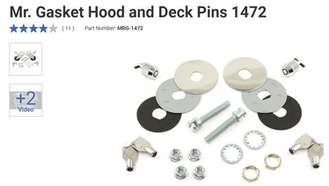

Of course, this does no good unless you also secure your hood. I installed hood locks when I first bought the car, in the early ‘80’s. These are installed in the front corners of the hood and use round (difficult to pick) keys that lock the hood to the radiator support structure. They are still available for around $30.00, and look like this:
All you see is the chrome washer (aprox. 1½” diameter) with the small key lock in its center. This solution only works if you are willing to drill your hood. Personally, I don’t worship my car, but really love it and want to keep it. When it comes to defeating a normal predator, I guarantee it’s very difficult to hot wire a car that has no ‘hot’.
