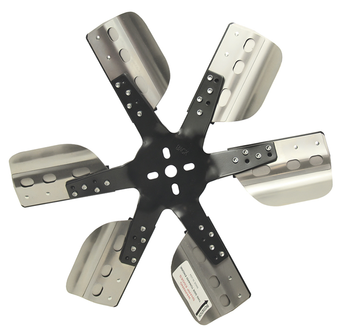

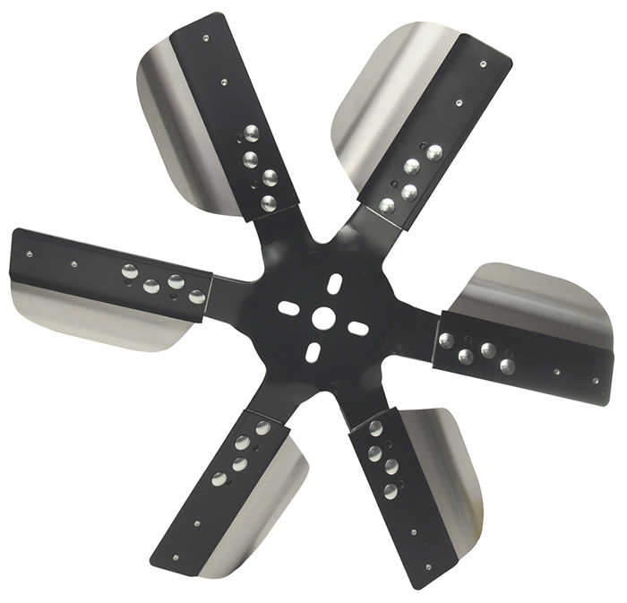

Part Number 17017
17" Heavy Duty Stainless Steel Standard Rotation Flex Fan, Black Hub
Ask a question about this product
DescriptionRated up to 10,000 rpm, our 17" diameter heavy duty standard rotation fan features thick black steel hubs and 6 stainless reinforced blades with a large surface area that improve performance and fuel economy.
Specifications
  • Diameter: 17-1/4"
  • Flange bolt spacing: 1-3/4" - 2-1/4"
  • Depth: 2-3/8"
  • Mounting surface to front: 1/2"
  • Mounting surface to rear: 1 7/8"
  • Rotation: Standard (clockwise)
  • Hub construction: Powder coated black steel
  • Blade construction: Stainless
Features
  • Improves performance and mileage
  • Heavy duty steel hubs
  • Durable stainless blades
  • Rated up to 10,000 RPM
  • Large surface area pulls more air at low speeds
  • Reinforced blade construction extends fan life
  • 17" standard rotation flex fan design

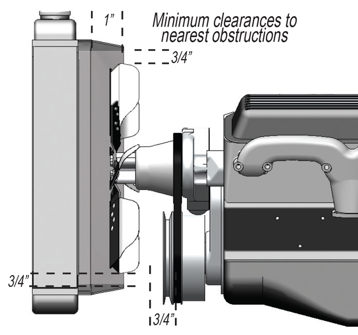

Looks like a good price for the fan. A lot cheaper than the electric setup, just be sure to use a shroud.
