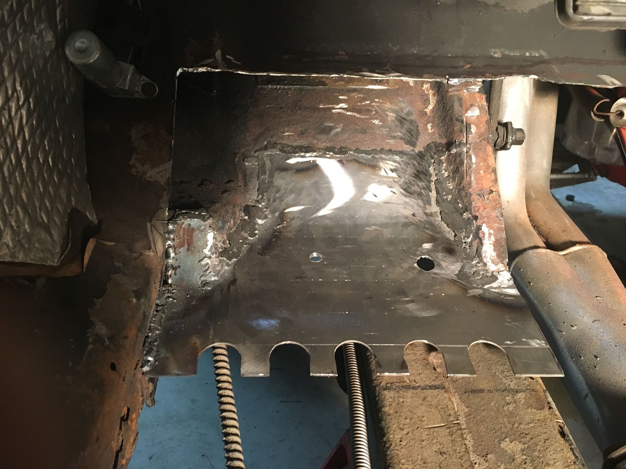

Drive Side Brace?? Trying to figure out what brace I am working on. I believe it is (LH firewall to floor brace) but am having hard time comparing what I see to order to match with what I see now on car. Can anyone help me, please! Hate ordering parts over internet and then get wrong part.

After investigating further I believe this is bottom of firewall were it attaches to floor. Have floor all cut out and ready for patch panel to be welded in but need to find a fix for this. Can find nothing for a weld on replacement part on internet and firewall replacement is not an option. Desperately looking for some options, Might cut this off above rust and try fabricating something but that is pushing my ability and not sure I'm capable. If anyone can come up with some options I would be great full. Kinda stuck and not sure were to turn. Thanks all for any help.

No, thought it was but looking from underneath not right part..Found a sherman part tonight that looks possible. Dash to floor brace, need to go over car better tomorrow to verify.

Fabracaited new piece to replace rust. Looks like it should work. Finishing touchs on floor pan and ready for install. Would have liked to replace whole brace assembly, but since car is assemblied couldn’t so did this.
