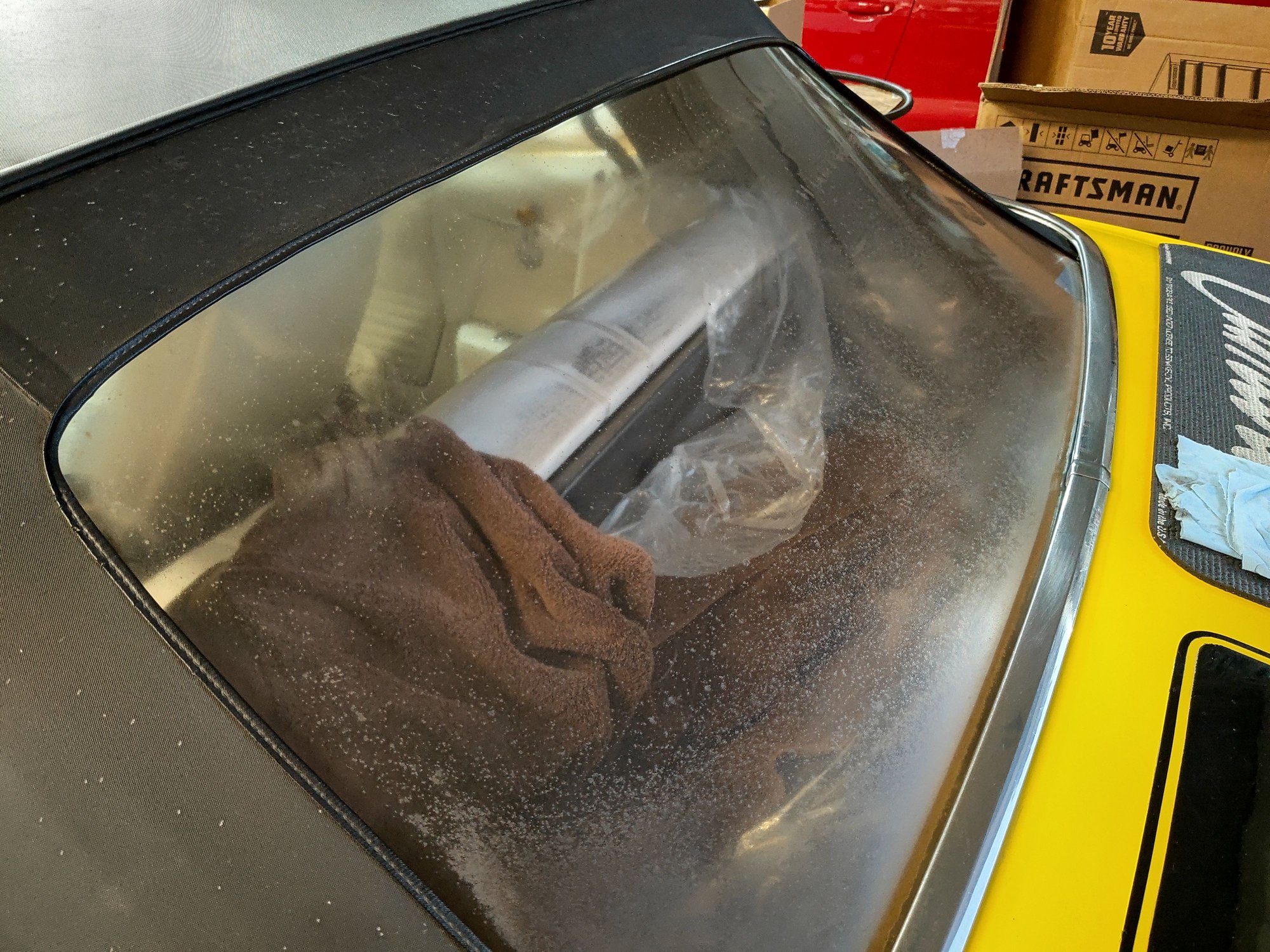

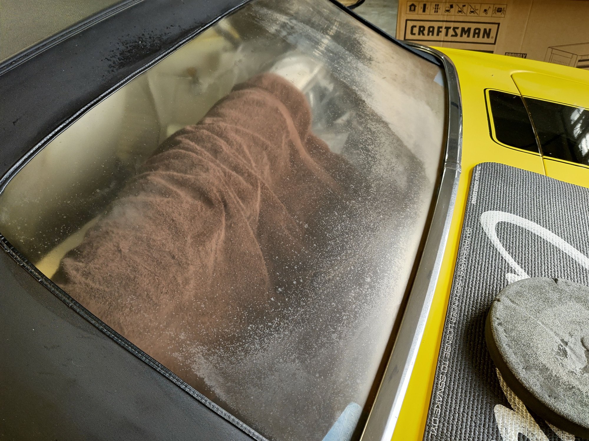

I have to replace the back window in my '69 Camaro, and I'm debating on what to do for replacement. I am considering whether to go with a white top (I have a white interior) or stay with a black top and what kind of back window to get; split glass, zip-in plastic, or original plastic. I've tried polishing the plastic and had some success, but not enough to make it safe to drive. I've heard bad about all of them. I know this crowd has an opinion and hopefully some helpful information on that decision. Pictures would be great too.
