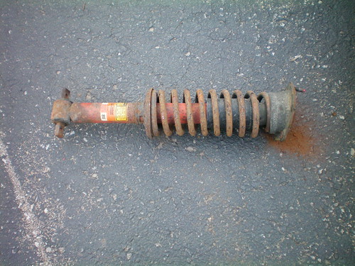

Replaced front struts/springs and swaybar endlinks:
