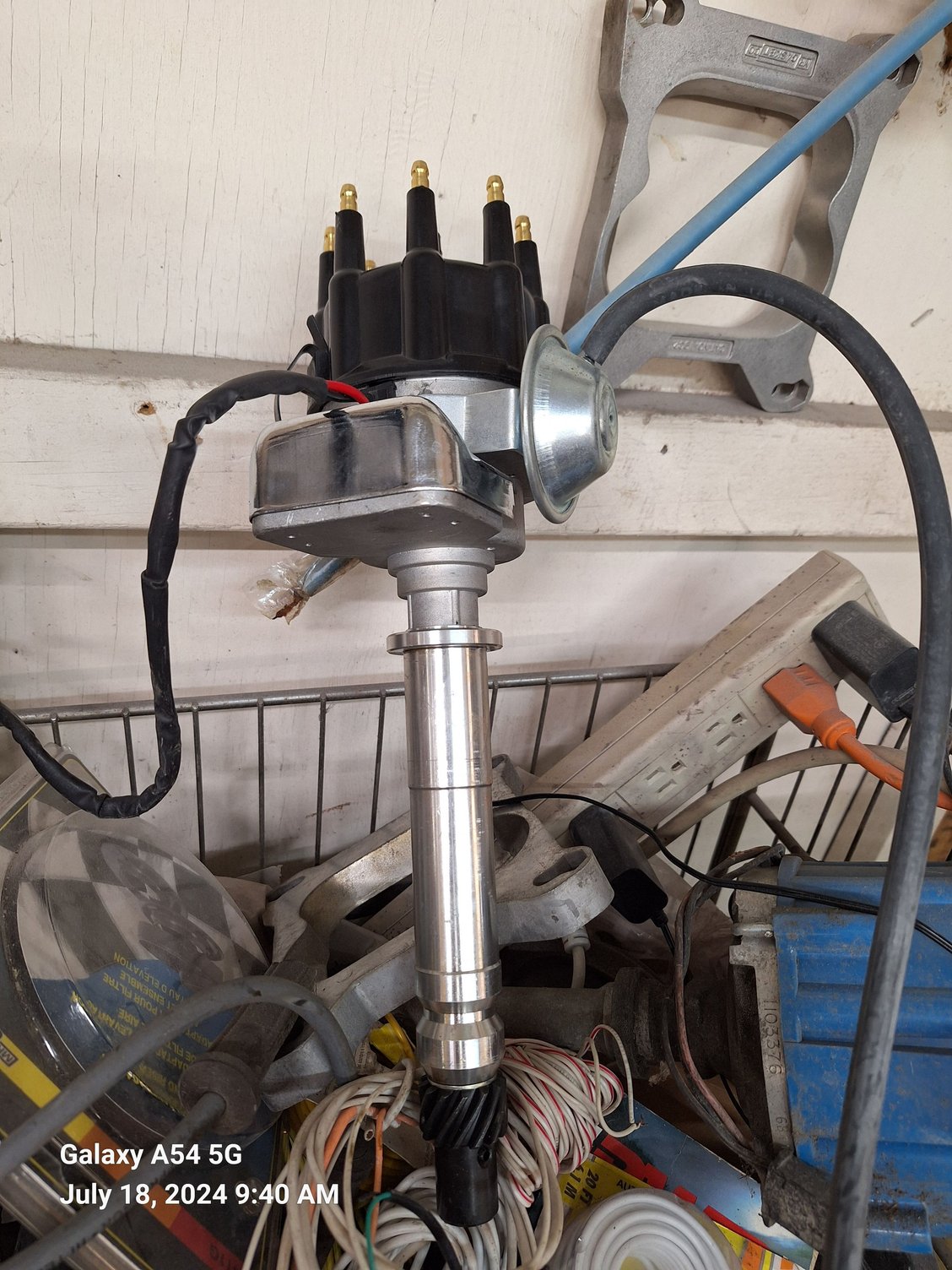

Default This kind?
I have this one already. I friend picked while i was away. Do you recognize it?

Not familiar with that one
MSD 8360 is commonly used in SBC.
A stock points distributor with a Pertronix module if you want to keep a stock looking distributor which is what I have along with a Pertronix coil mounted in stock position
If you mount a coil, oil filled, not straight up, they leak. Use a solid core coil which are readily available.

The MSD I noted is not a points dizzy. It is an HEI but requires a outboard coil like a stock points dizzy. It is not the GM HEI with coil in cap dizzy. Those will work but require denting of firewall to fit as the base and cap are much bigger than a "small body" type
