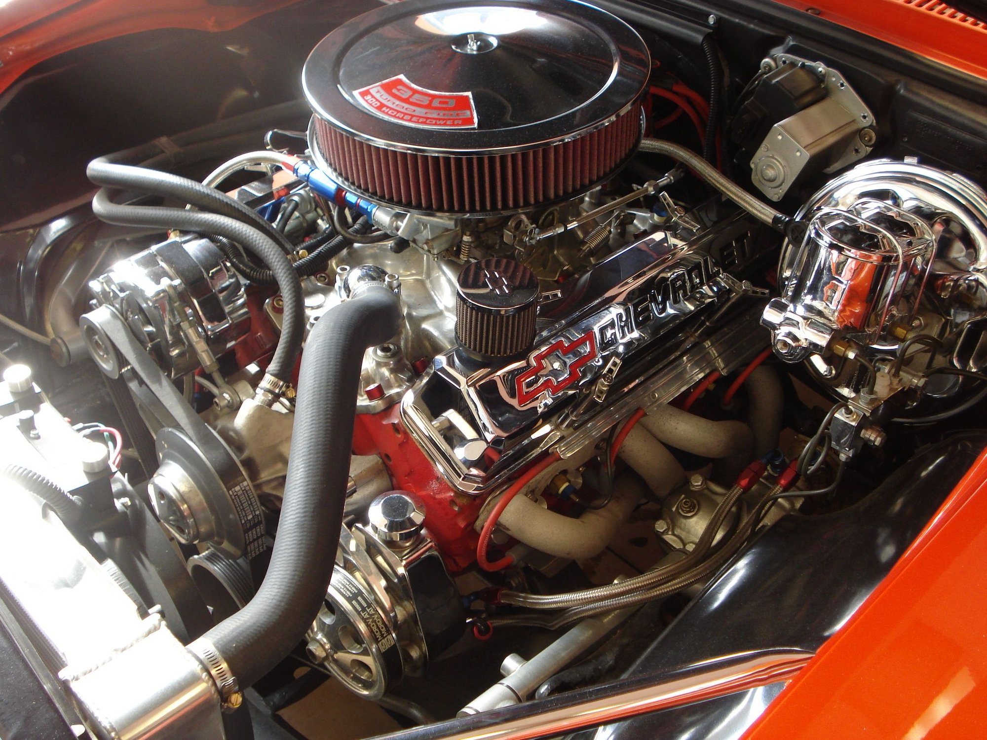

You can see the upper hose crosses over the plug for temp sensor

Due to the plug next to tstat, this is probably why they put it in the head

That blue plug is a coolant source, try the sender there.

You can try ther blue plug port, but there is not a coolant run, like up front, and its at the rear of the block/head and still going to indicate hotter.
But try it, can't hurt.

The coolant from the block enters the head at the rear and flows forward towards the tstat, so there is flow back there and it hasn't cooled the head yet so it might show a cooler reading.
