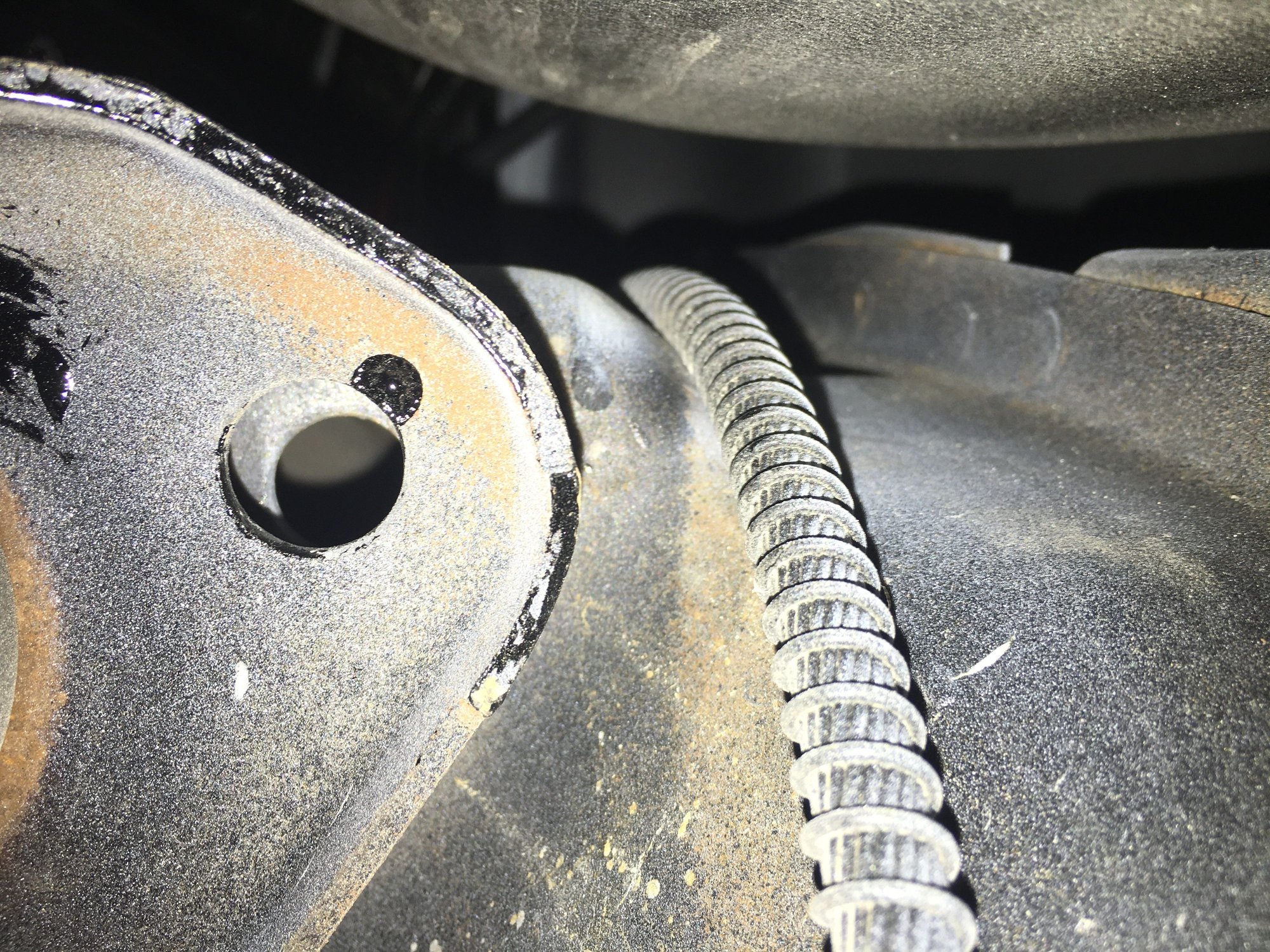

At the A pillar, right where the sub frame body mount bolt is, there is an alignment hole just outboard. Use a 5/8" long bolt and see if it slides in straight. These were the alignment points the factory jig used when the sub-frame & body was mounted.

Without taking any measurements yet I would say I will find this car all over the place. The passenger side looks good. The driver's side not so much.
Back to my first question. Can I loosen all the bolts and make this adjustment without taking the fenders and hood off? Everything is in the car and I was getting ready to put in the Glass. Then this little monster appeared. Once again the first body shop has sc****d me.
Passenger Side
Driver Side

I wouldn't start unbolting everything unless you know that this will fix the problem. The factory used those holes to line up the frame and body, but by the time final bolt down was complete, the holes didn't always line up.
If I'm picturing the movement of the body vs the frame and you line up the hole, this should pull the drive side frame back to the body. Now your car will pull to the left. You would then need to re-align your steering again, but that part I'm not the one to help?
