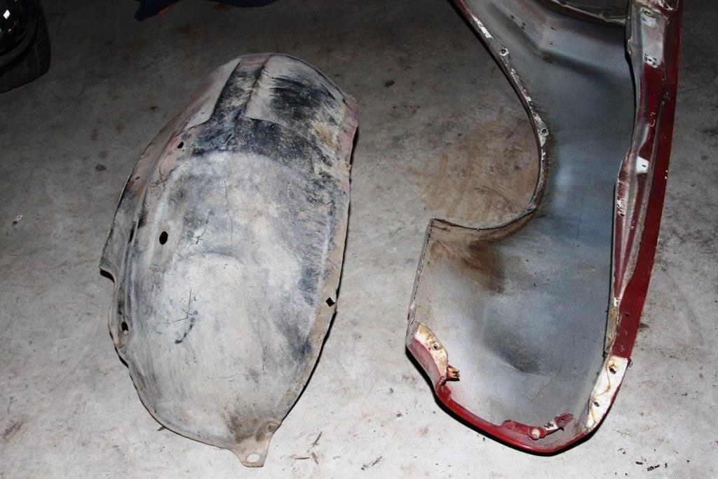

Thank You, looks like somebody "trimmed" my inner fenders as looks like missing two holes that bolt to the side of the support.

You're welcome Pictures? It's just a ledge for bolting to the support.

What I am working on. is an original SS/RS 4 speed Camaro according to the trim tag on the cowl. Is a Jan 4th week production car.
