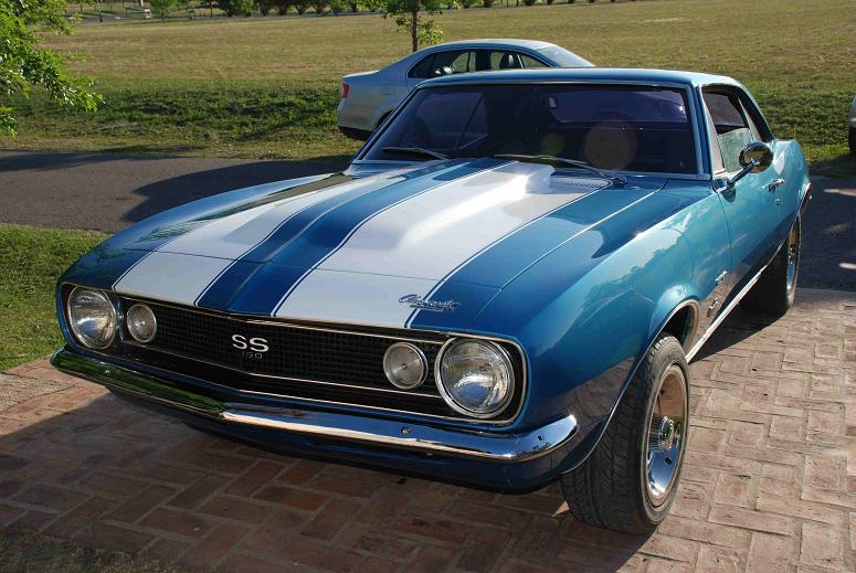

I have a 67 Camaro with a 4 speed ZF gearbox which was in the car when I bought it, and a GM Performance ZZ4 engine which puts out about 355HP. I purchased the engine new, but left the old gearbox in. The old gearbox seems to be on its last legs, so I am thinking about putting in a 5 speed.
Does anyone have experience in having installed a 5 speed into a 1st gen Camaro ?
Which gearbox on the market would you recommend ?
Besides the gearbox itself, which other accessories (shifter, etc) would I need to purchase ?
Thanks
Jeff
