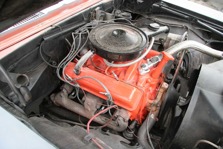

I have an older style 327 that has the oil filler in the front top of the manifold, but the newer manifolds don't have the slot for the filler in the front. Chevy converted the late 68 327's to the filler in the valve cover style.
Will the newer manifolds cover the filler hole in the block, or do I need to use an older style manifold?
An suggestions on how I can do this?

Picture of my 327 engine....

Sorry....I just searched and found "Edelbrock 27034 Performer EPS Intake Manifold with Oil Fill Tube and Breather"....I guess you can find them. Thanks,
Old Jul 31, 2010 | 10:32 AM
For the record, there's no "filler hole in the block". A manifold like you have just dumps the oil in the front of the lifter valley.
