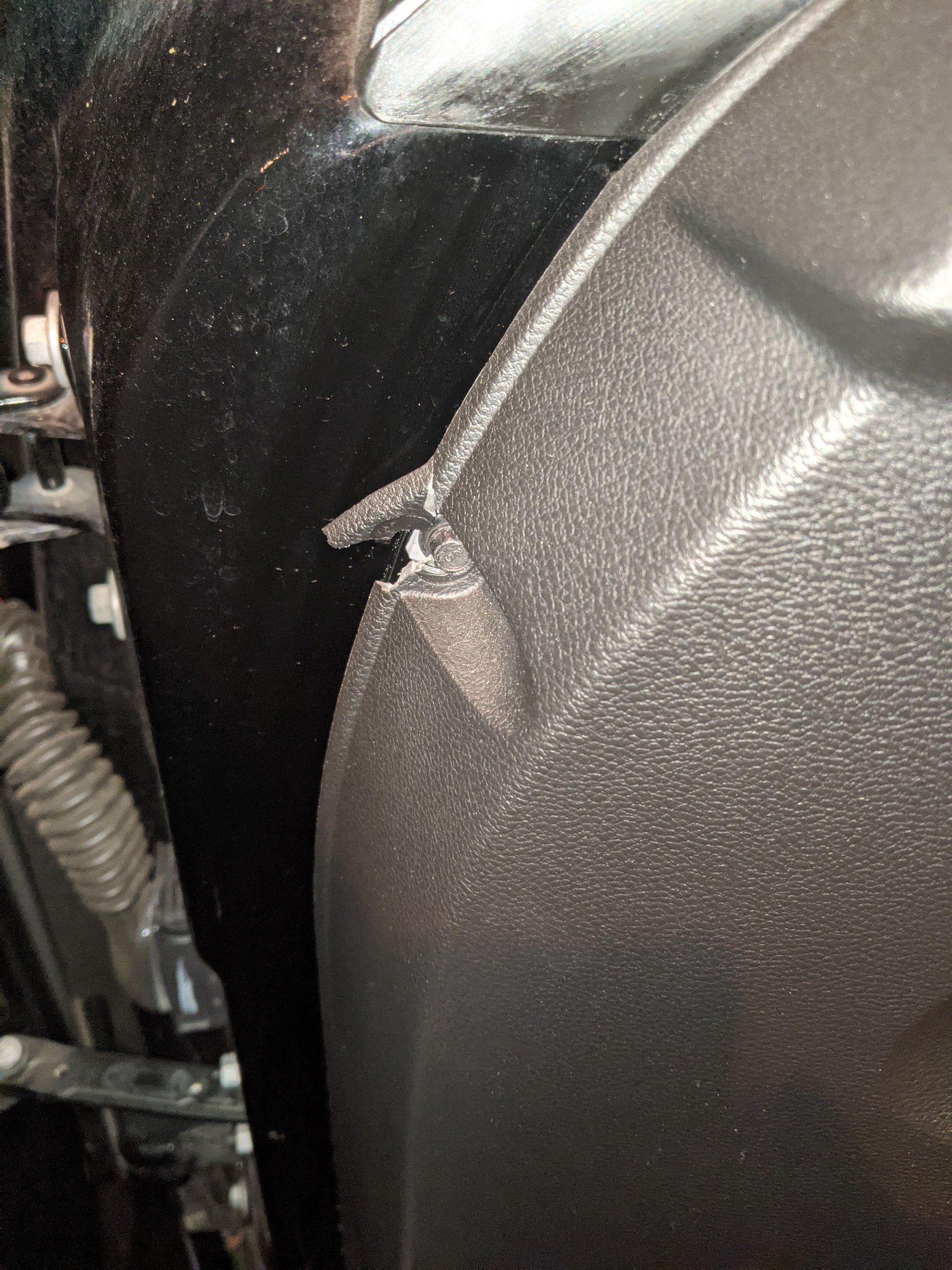

We'll I decided to just take it to the dealer and get it taken care of promptly and professionally.... Right. For $300 they resealed the deflectors on both doors and I believe the leaking has stopped (I'm still drying it out so it's hard to say for sure).
But now the passenger side door handle doesn't work. ​​No big deal, made an appt and 4 days later they fixed it for free. I'm happy to finally have it done with.
But wait theres more. Yesterday I noticed that the passenger door panel which they have removed twice now is broken and not on snuggly against the door. What the #$&*. I'm called but the service manager was already gone for the weekend. So much for getting it taken care of right by the pros at the dealership. Wish me luck on getting them to fix the door panel...
Old Jan 17, 2021 | 06:27 PM
Posts: 22,037
plastic welder may be able to fix that. they tightened it too much.
