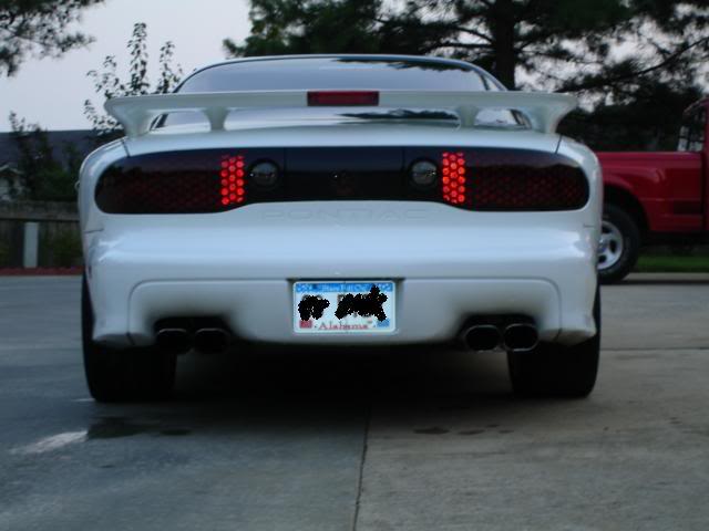

I can tell you in the back the biggest you could run is around a 295 width, I run a 275/35-18 on mine just b/c they are sooo much cheaper and really fit the rim good. I would also recomend for your car since it a V6 and traction wont be that much of an issue (no offence) a brand called Riken. They are very cheap I picked up mine for around 250 I think maybe less. I have z06 rims here is a picture from the back to show you how they look. For the front I would say something like a 245/35-17 would be good.

your car looks great. didyou lower it or is that stock height? i'll check out the riken brand. thanks for the input.

nah man it is on stock springs right now, I plan on lowering it in the future. Now my Riken made a roaring sound for the first couple hundred miles, but then that just went away.
