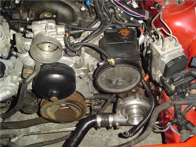

Ok so some very bad pics but here they are. Ignore some of the rust, oil, dirt, lose wiring, and parts its been a long project and she has not been driven in over 10 months but she is almost there.... FINALLY.
She has her factory shoes on due to shop conditions and theft issues.

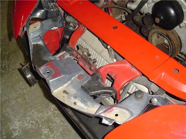

Another bad picture. You can kind of make out the intercooler and some of the plumbing back there.

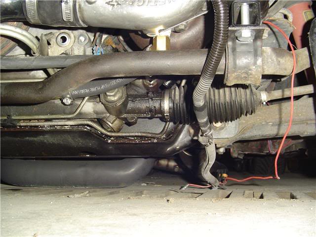

Nice and tucked away . Nothing more then a CAI and Exhaust [sm=guilty.gif]

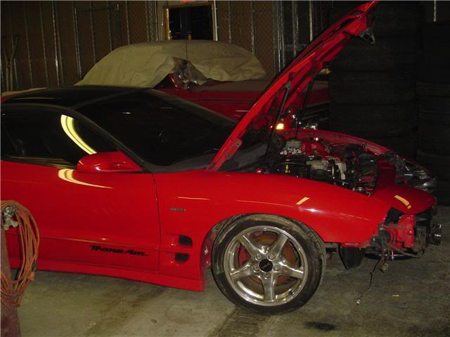

And now you can see my ground clearance issue. I am bringing the car back up about 2 inches with a new set of springs that should arrive at the shop some time in the morning. With some luck the car may finally get on the dyno some time this week.
