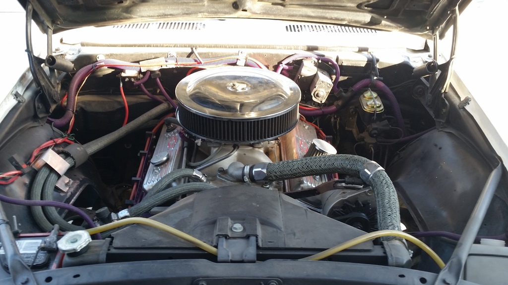

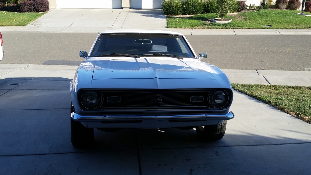

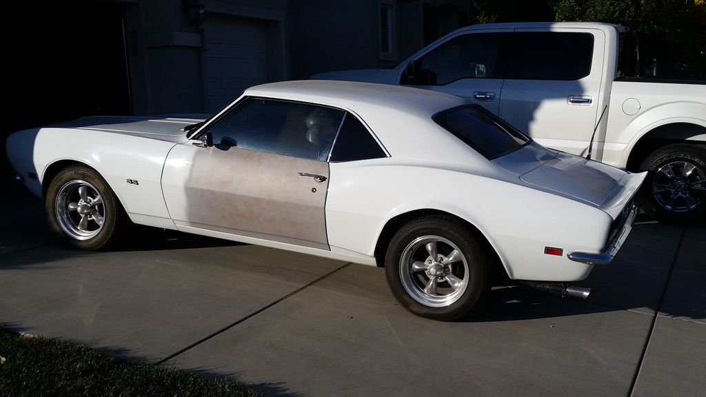

I couldn't be happier - The car runs fantastic and drives extremely well.
I have yet to figure out exactly what has and hasn't been done to the car yet but from driving it and doing a detailed inspection I am ecstatic for what I paid.
I am so fired up I just want to start ordering parts for the interior and getting paint estimates ASAP but I need to slow down and get a build plan together.
I have a million questions and cant wait to get started.

Welcome to Camaro Forums. Even though it's not the voted most popular ever 69, it's still a nice car. Congrats!
Looks like someone cut out the wheel openings and added a small flare to it.

Nice enough for a good start.
Camaro script on front fenders is missing.
Hopefully, you have OE window moldings as I have read some of the aftermarket stainless moldings don't fit quite right.
Heartbeat City is a good OE place, but then, you pay for it also.
Center bolt valve covers mean later heads or engine assembly.
Engine code is front deck pass side in front of cylinder head
The pad will have date engine made, place of manufacture/assembly, engine code as to what it was born as, and partial VIN of donor vehicle if not a crate engine.
