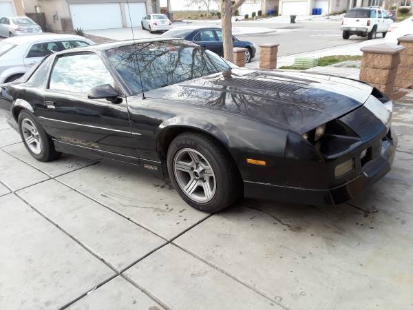

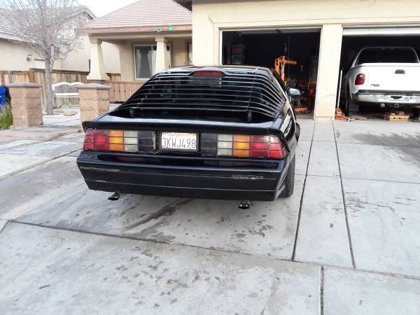

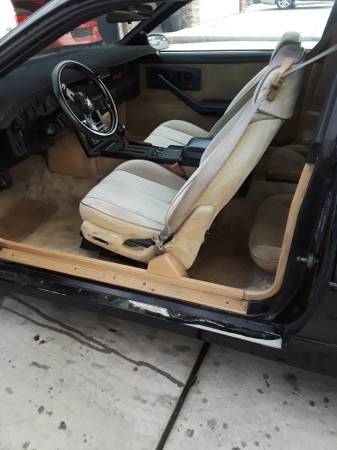

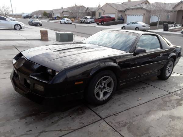

Looking to buy a older Camaro came across one yeatersay. Owner said it’s an iroc Camaro. Need help identifying if it’s a real iroc or not. Here are some pictures and info about the car. Thanks for the help in advanced.
85 Camaro z28 IROC Z 5.0 TPI the car is all original clean title not salvaged like all the other IROC Z car runs good shift good recently passed smog so you have plates until 2020 and it has all new tires and it has all Kenwood speakers and stereo...auto transmission

All 85 irocs have salvage titles? Check if the engine is number matching. The 305 TPI is pretty rare in 85 and it was only in Iroc cars. If it had a different engine it could still be an iroc. But if it TPI from the factory its a top level Iroc.
There was a small amount of cars made in California that had a 305 TPI but none of the iroc or Z28 badging or markings not even the hood. They were factory "sleepers" and if someone had one I doubt they would make it look like a z28 as they are very valuable.
