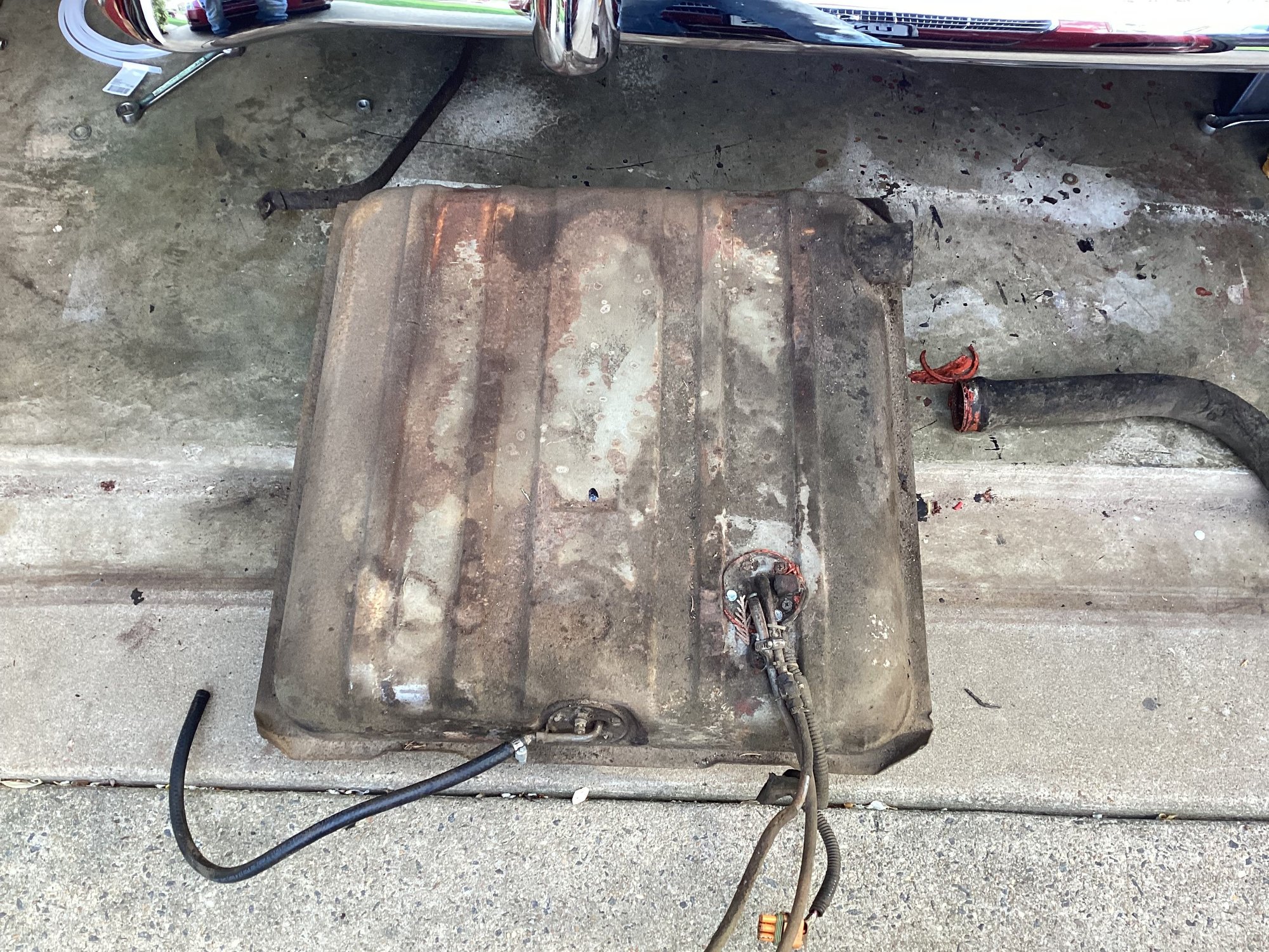

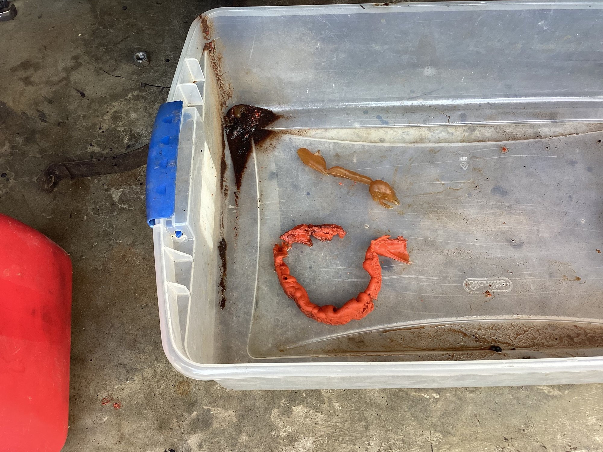

Default Cause of random stalling
Problem turned out to be fuel starvation. Whoever modified the original gas tank to accept an internal pump for the engine, did a poor job. When I dropped the tank, I found numerous globs of red silicone like material floating in the tank. When fuel was low they must have been restricting gas to the pickup tube, by clustering around the strainer. I can envision when the car stalled and pump no longer pulling in the globs, they would drift away and the car would start again.
The culprits
The culprits
Modified 55 fuel tank

Posts: 22,024
wow, just add more gasket maker,,, not. who woulda thought. kool that you found that. have a great weekend.
