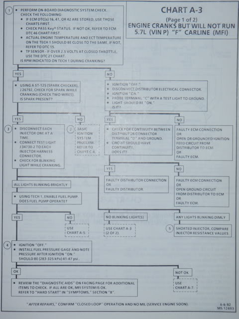

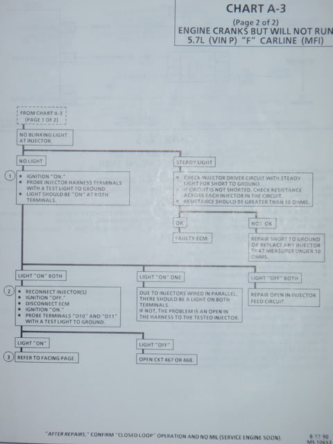

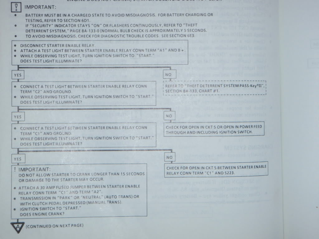

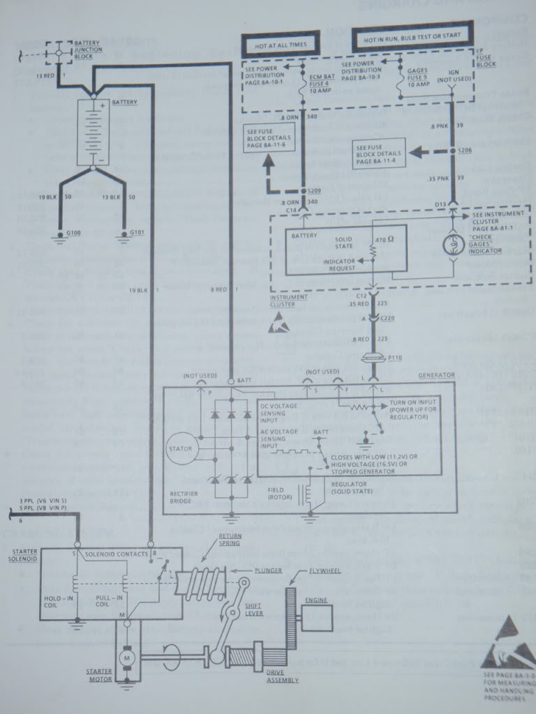

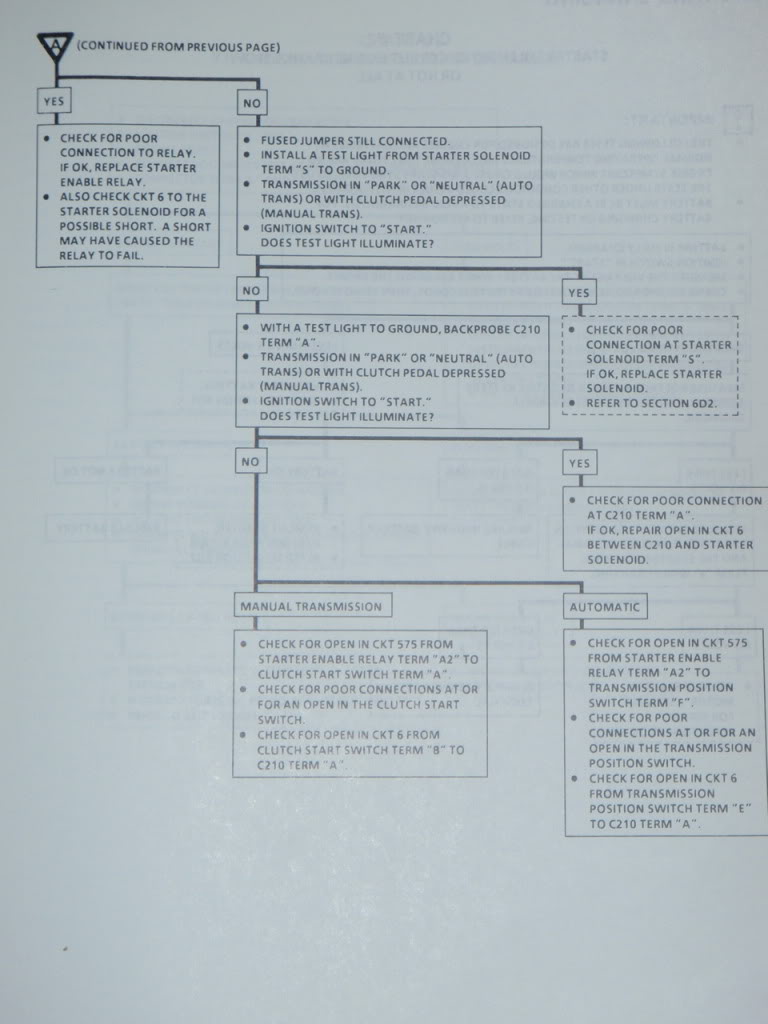

from a 93 factory shop manual, should cover a few years. hope its usefull for someone
