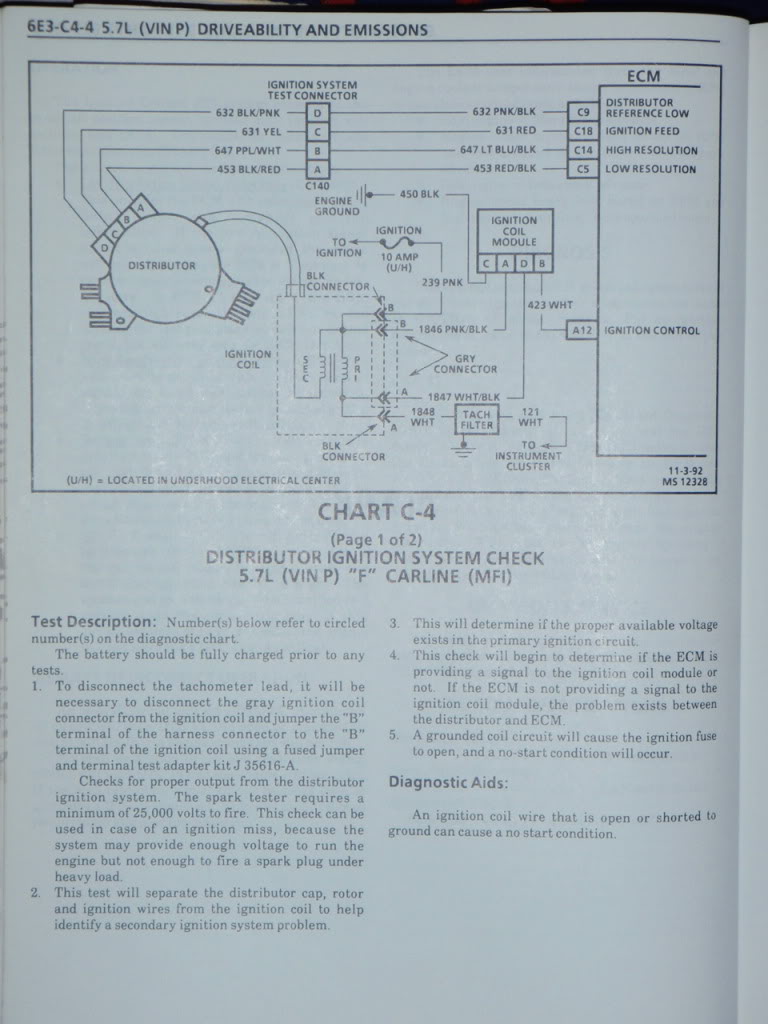

craby 10-21-2011 05:39 PM
your lt1 turns over but will not start
13 Attachment(s)
from a 93 factory shop manual, should cover a few years. hope its usefull for someone
http://shbox.com/1/4th_gen_tech2.html#opti_test
Attachment 23321 Attachment 23322
Attachment 23323 Attachment 23324
Attachment 23325 Attachment 23326
Attachment 23327 Attachment 23328
Attachment 23329
Attachment 23330 Attachment 23331
Attachment 23332
Attachment 23333

craby 06-16-2012 09:42 PM
4 Attachment(s)
chart c4
Attachment 19376
Attachment 19377
Attachment 19378
Attachment 19379
craby 07-18-2012 10:43 AM
test igntion coil module
