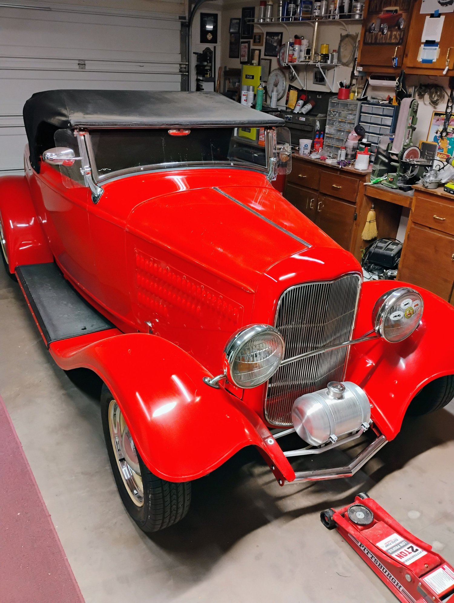

OK, the roadster has been laid up for several months while I put fenders on it. Engine is a 1994 from a Camaro or Firebird with a 4L60E trans. Factory style wiring and ECU. Today I took it for a short spin, went two blocks and got gas then up the road a bit. About 1.5 miles up the road, engine temp about 160-170 it started to miss. Run...die...run...die. Finally got it's act together and ran right. Got home and checked the light (it's in the trunk...to lazy to run a wire up to the dash). No Light! Which I can assume no codes. Started acting up just about the time it goes into closed loop. Any ideas?
