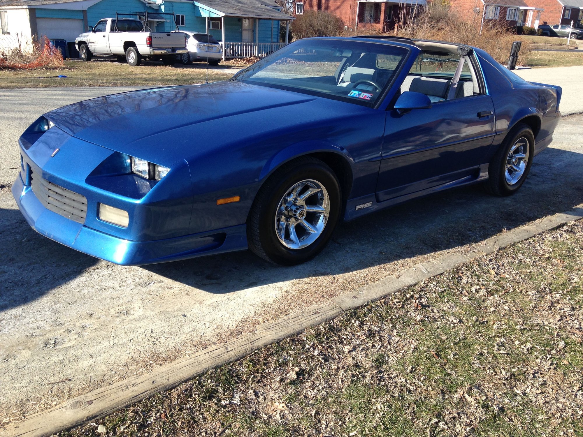

So my check engine light in my 1991 camaro rs just flashed for the first time the other day actually was the day after filling up my gas tank, soon to be shortly after that it stayed on for a period of time where the car seemed to be idling really low with a slight front end shake, then it will stop and the check engine light disappears and the car began to run as if nothing was wrong at all, a day later I change my fuel filter and it seemed to help but then I took it for a spin and it started to act up again with the check engine light flashing on an off and car idling very low then eventually it got bad enough that it actually stalled out for a period of time and couldn't get it to start back up without having to put my foot in the gas pedal but I was able to drive it home in that condition but my speedometer wouldn't work, occasionally the check engine light would disappear and everything will run fine but wasn't for long... I got it parked out front the second I pulled in the spot outside it instantly stalled, the next day I woke up and the fricken thing started right up no check engine light or anything.... I feel like it's a very little issue I don't wanna take it to a mechanic if there's anyone who can help me please
