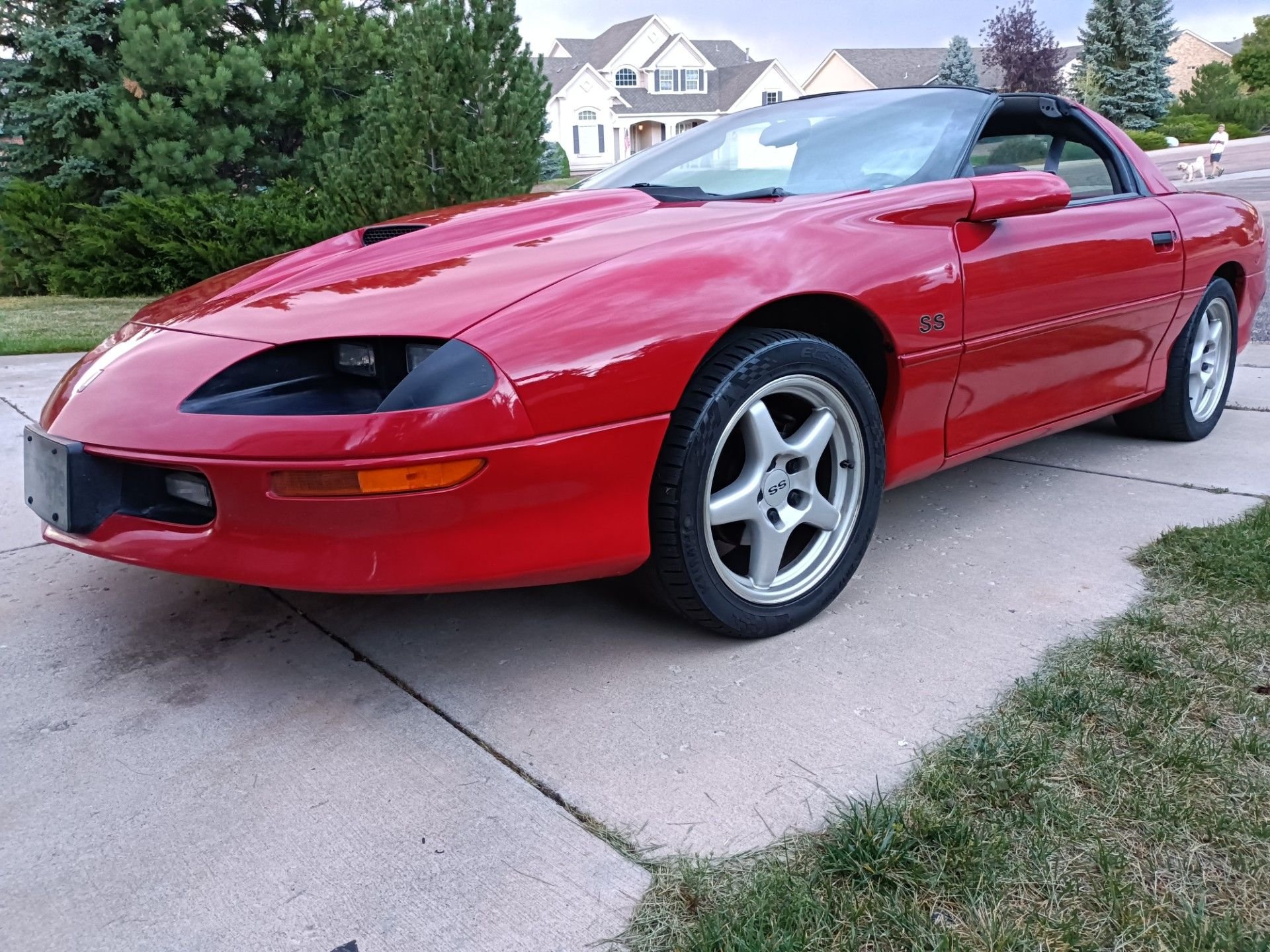

Ok, I just joined. In case you missed my introductory thread on the New Members forum. I have a 1997 SS 6-Speed. Stock except replacing the 2ONTL exhaust to a loudmouth. I didn't think it was sacrilege since the car and the exhaust were both made by SLP. Seems like the car is down on power. Now, since I live at 7,500' above sea level I'm losing about 25% anyway but it used to be better. Recently I got a code for cat inefficiency and I tried tricking the computer with an O2 spacer you can buy legally from Walmart, But I still have power loss. I've never modified anything else. Maybe 70K miles. No sputtering, missing, or anything like that. The car has been problem-free except of course window motors.
The car has every option GM and SLP could put on it except traction control. Even crazy ones, like the SS car cover and an extra set of wheels.
