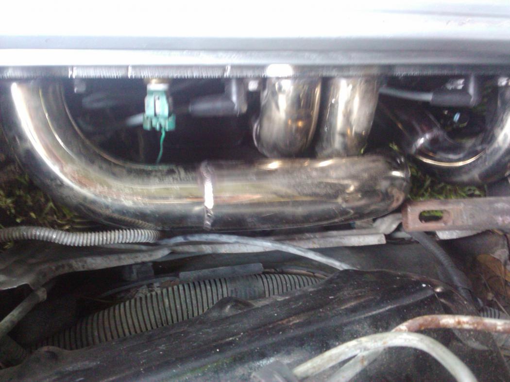

got pictures of my problem. I heard that you can undo the steering column and it will adjust to the right about 3 inches is this true??

looks like the wrong headers, the brake line is way to close and there is no way the steering is fitting in there. what headers are these?

Ebay. go figure...

heres mine and its tight but a nice looking fit.

wow that is tight. looks like your column sits a little more to the right than mine though...
