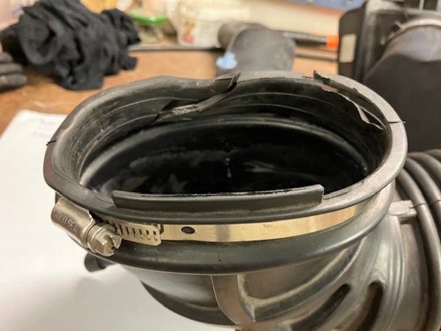

Had it off yesterday and it can definitely do with a cleaning, also my Elbow rubber is really torn in the end towards the TB although the clamp likely is keeping together when tightened

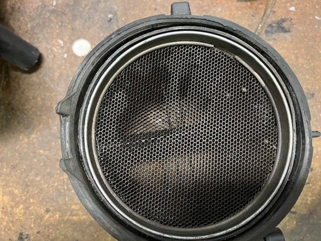

Small update: this weekend I cleaned up the MAF with the appropriate spray, the honeycombed part was dirty while theinside with the three leads looked rather clean.

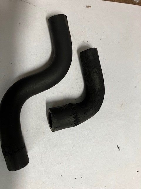

Also replaced some of the dried out small vacuum hoses on the passenger’s side of the TB, they were not really broken but had several small cracks in them.

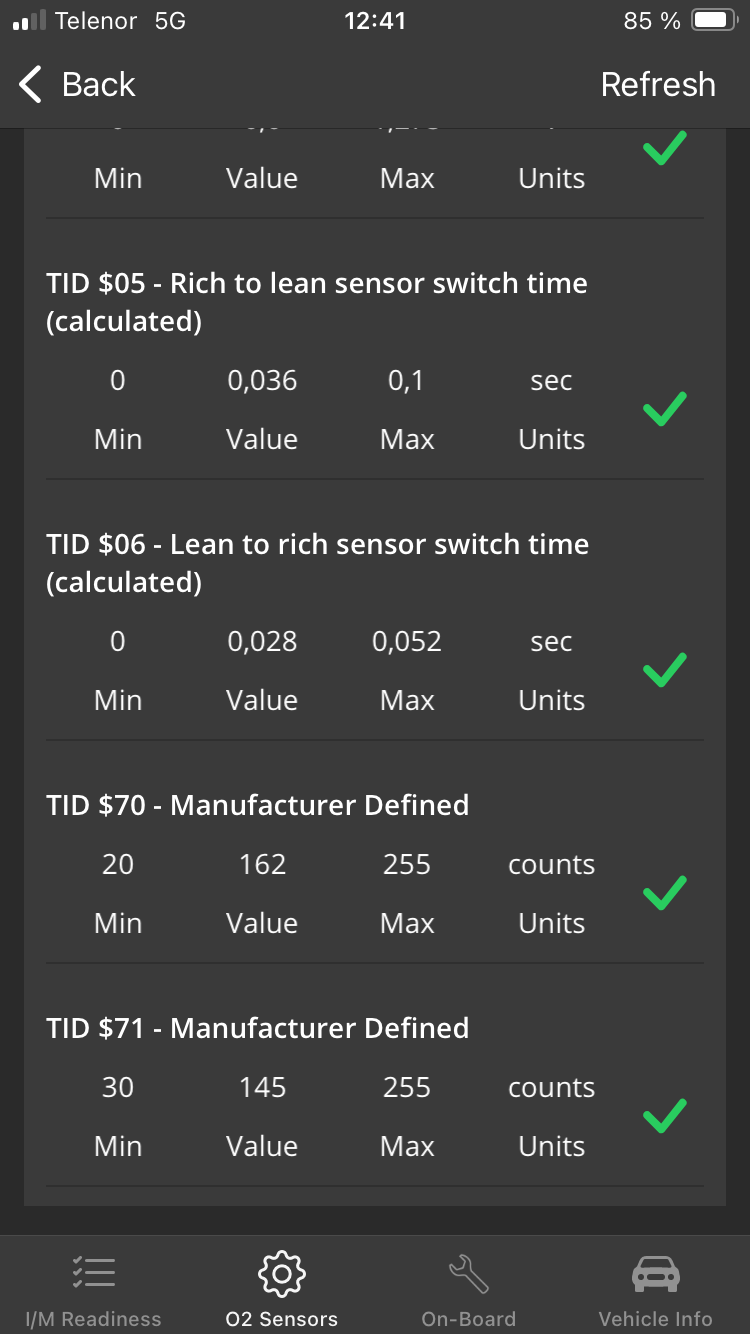

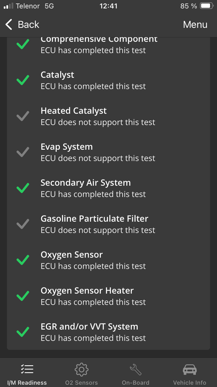

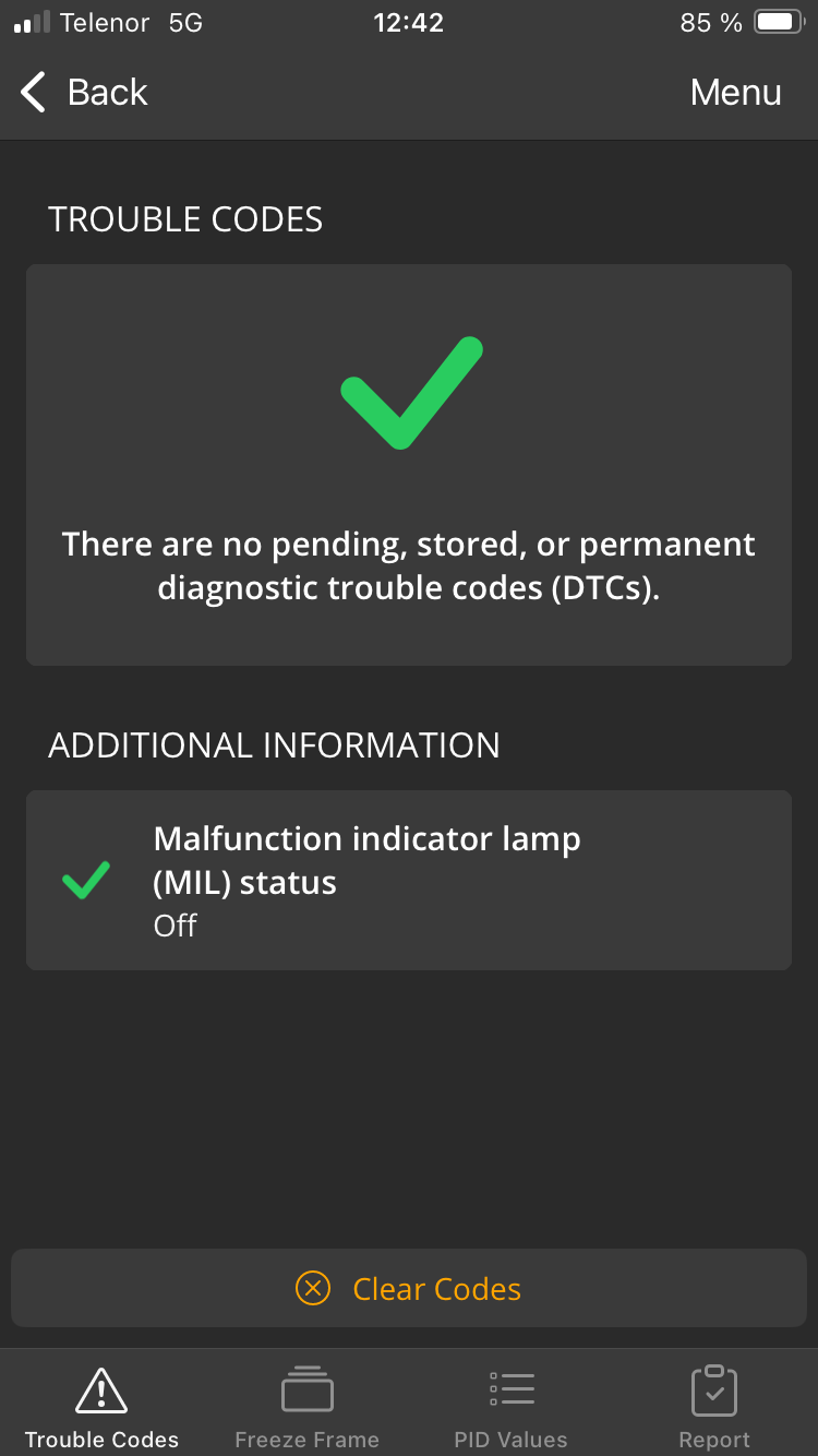

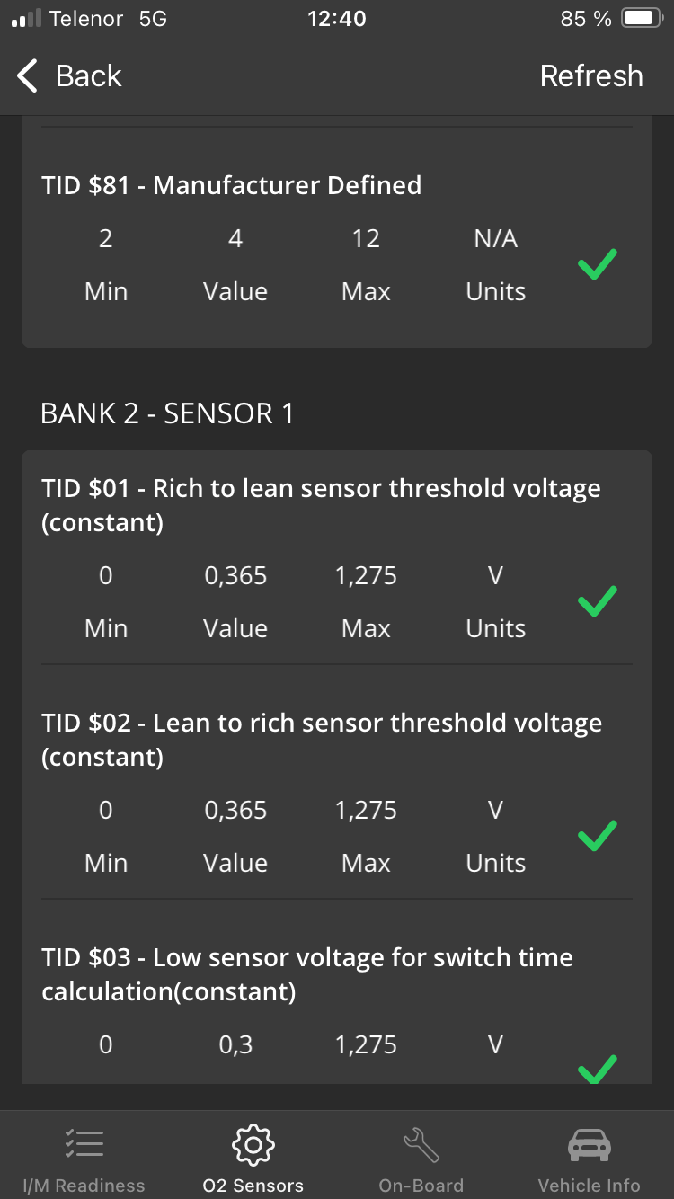

Manged to monitor via my OBDLink dongle & app, and share the result here, engine fully warmed up and idling.
Found nothing to shed any light on the surging issue though, not sure how much live data you can get from a LT1, but a dream scenario would be to be able to see what engine parameters that are lively in there as its seems to be a regulating issue.
Have been thinking on consulting a professional tuner

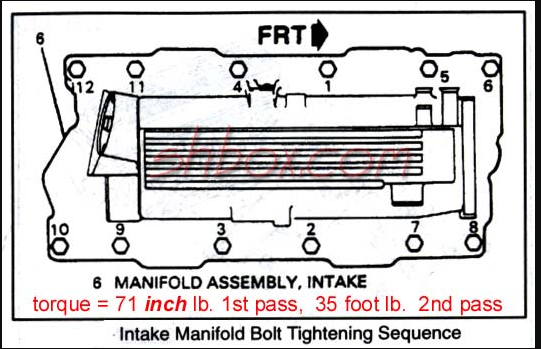

did you check intake manifold bolts for tightness/torque down.

No I haven’t, did spray some brake cleaner in that area though, but it’s a good point, I’ll do that tonight, thanks Craby!

Got to check half of them last night, and so far they were rather poorly torqued (wrench set to 48 Nm) and one even loose, will do the rest asap
Have a small hope this might be causing the surging.... but we will see, I will report here regardless

Was some work to undress the engine to be able to tighten all the intake manifold bolts and studs, but now it’s done (except for #11 under the fuel regulator that was harder to get).
Sadly, it had no effect on the surging, but they should not be loose regardless, so the work was not done in vain.
