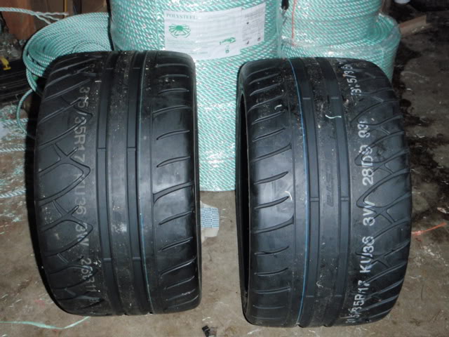

yours look like this only not as wide, these have r2 and have much better traction if you warm them up good.

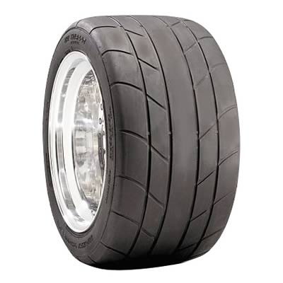

Ok craby i looked on the MT w/s and didnt find any DR's that looked like those or in 315/35 on 16" rim.

well crab,,, my bad, used wrong pic. they were kumho and sucked, my first pair of 315s. should have been these
