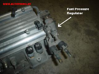

1. got spark[/align]2. checked pressure of fuel rail: was 50 psi but dropped to 30 psi after the first 2 seconds of the key being on, then steadily fell after that[/align]3. checked lines and injectors for leaks, did not see any. gas cap tight.[/align]4. replaced fuel filter - the gas was clean coming out of the old filter[/align][/align]i read the sticky about testing fuel pressure already but i would like some more information[/align][/align]i asked some friends at school and they think it could be the fuel pressure regulator[/align]they mention blocking off the return line and i would like to know how to do that[/align]

Regulator could be bad but most times the pump is shot. Pressure and return lines are easy to access right on top of the intake.

Fuel pressure should only drop if the engine is running as the regulator needs a vacuum source in order tocontrol the fuel pressure. You may have a bad pump,bad regulator, leaky injector, or plain old fuel leak.

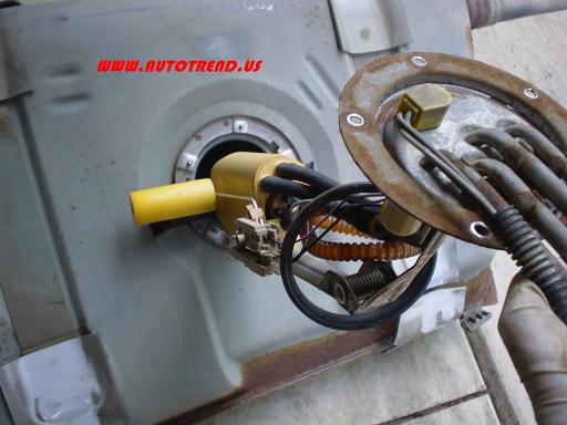

so i put the fuel pump in this weekend and still the car wont start
next weekend im going to check the regulator

You sure you installed the pump right? What did you do with the pump enclosure?

i'm sure i installed the pump right, it still cranks and cranks like it did with the old pump
im not sure what u mean by the pump enclosure
