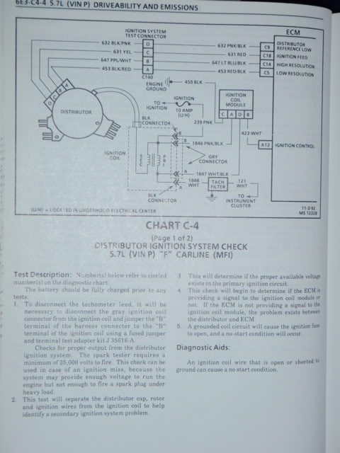

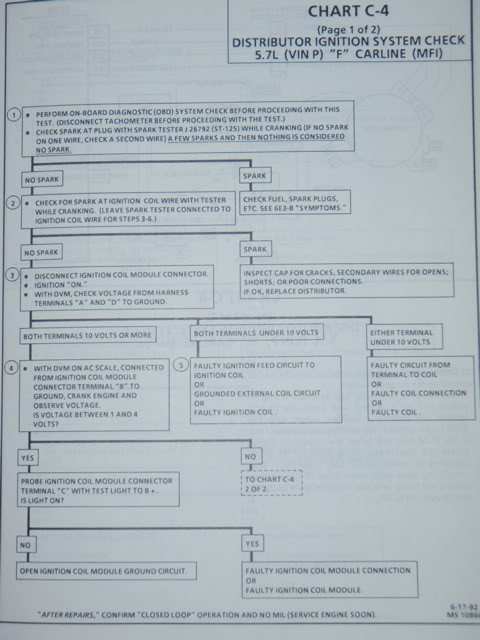

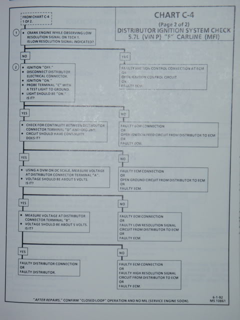

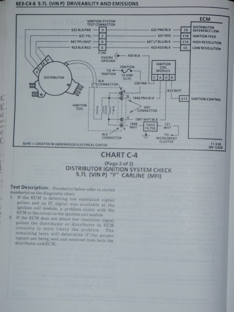

Old Sep 8, 2010 | 12:59 AM
Posts: 22,022
Size:  57.8 KBName:  P6030002_1-1.jpg

I don't see any test in the diagrams for conditions with spark. It does have good spark coming and going to dist. Is the noob (me lol) missing something?
