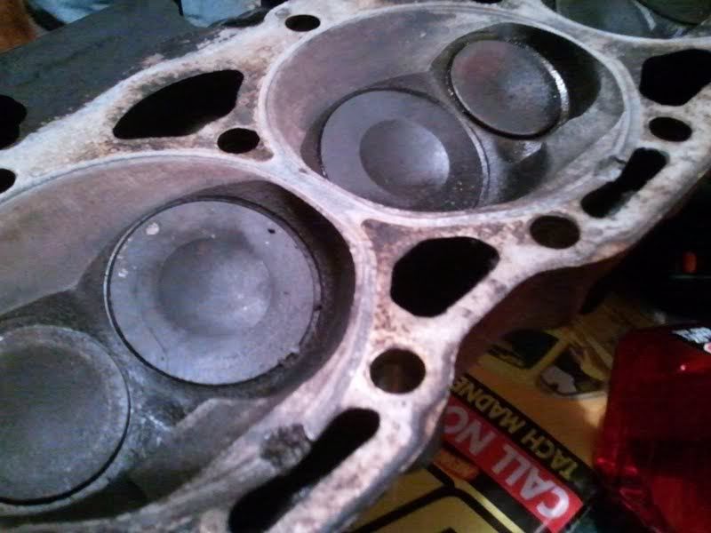

well I found my problem.. I've been tearing into it the past couple days to find a clearly detonated cylinder head. gonna see if I can go ahead and get them welded and machined for cheaper than a set of used ones. I'll pull the other head tomorrow and see how bad it is first tho..

lol, tried to post a pic.. not sure it worked
http://i721.photobucket.com/albums/w.../burnthead.jpg
check it out there lol
Old Oct 5, 2010 | 09:01 AM
Oh, those don't look so bad, you should be able to epoxy those pot holes!
Seriously tho, it looks like those spots were corroded through from the water jacket side.
That's a poster head for showing why you want to flush the cooling system frequently.

ya, idk maybe that is what did it. they're really not too bad tho. I got the other head off today, it was fine.. no cracks or anything like the other head lol. I called my machinist today, he has another shop that will be welding up the head and then he'll be finishing the work along with cleaning the other head and trueing everything. hopefully it'll all work out
