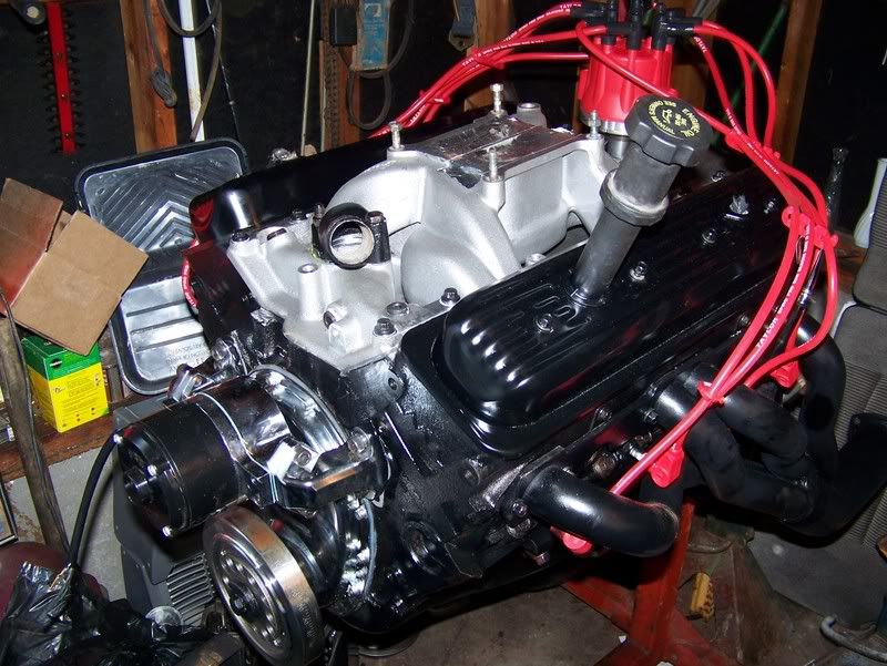

I would find a way of measuring the cylinder volume you have now before I would look at increasing the compression you would gain around .5 in compression losing .04 cc of head volume. With 0 deck you could be over 10.5:1 with a 64cc head depending on cam choice you could be approaching the race gas range real quick. For the retainers I would look at having the machine shop cut down the guides you might not need to increase the spring pockets depending on cam choice. The aftermarket retainers either operate with beehive springs$$ or are raised making them heavyer the cost is probably a wash and the machining is the better way to go. We only needed .010 clearance for the cam we have so we ground down the bottom of the retainers if we were really serious about an engine I wouldnt do that. We have our vortec headed budget engine in the car and need to get the wireing and everything else done and then we will see what happens [8D]<center>
