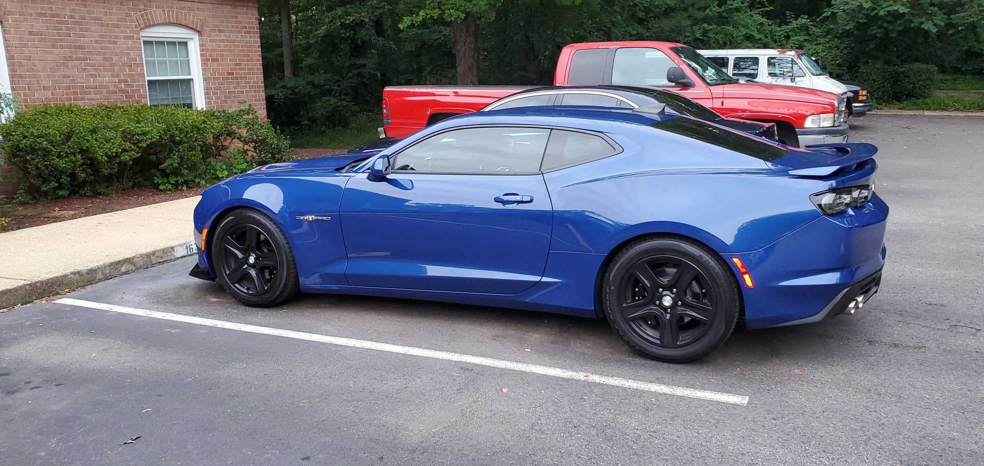

This is the best pic of "MAXINE". I bought at Carmax with 3.6k on it. Brand new as I could get and I changed the whole suspension with Bilstein B14's. They are zinc and yellow coilovers with blue lowering springs have been tested at the Nordschliffe and made in Germany. I lowered it an inch but my $20 GM end links are not adjustable. I bought BMR ELK-016 (made in USA) aluminum front adjustable end links to lock down the struts and sway bar so it all works together. I am making an appointment at Summit as soon as I get her dialed in.
