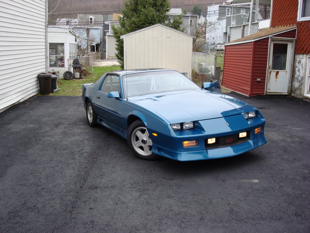

91 Camaro RS (305 - 5.0) automatic with a rebuilt motor approx. 3 years old, after several months sitting in my driveway, I'm finally getting around to putting some time and money into this car. Paint was really getting bad, so I took it to maaco and let them paint it (was shocked at the excellent job they did IMO), replaced the cloudy driving lights, then did the routine maintenance (oil change, trans checked etc...). The car runs fine as is, however I do have a couple of questions I was hoping someone could answer and possibly point me in the right direction.
