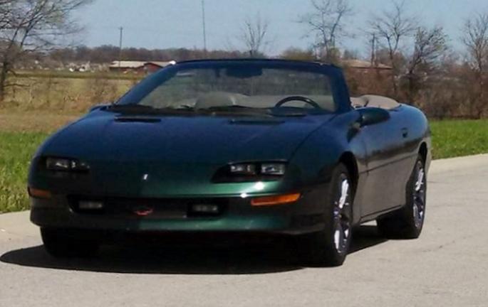

18x8.5 front with 245/40x18 & 18x9.5 with 275/35x18 rears. 56MM offset front & rear. Rear wheels needed a touch from a dremel due to the center bore being about 1.5mm undersized. That took all of 5 minutes per wheel.
