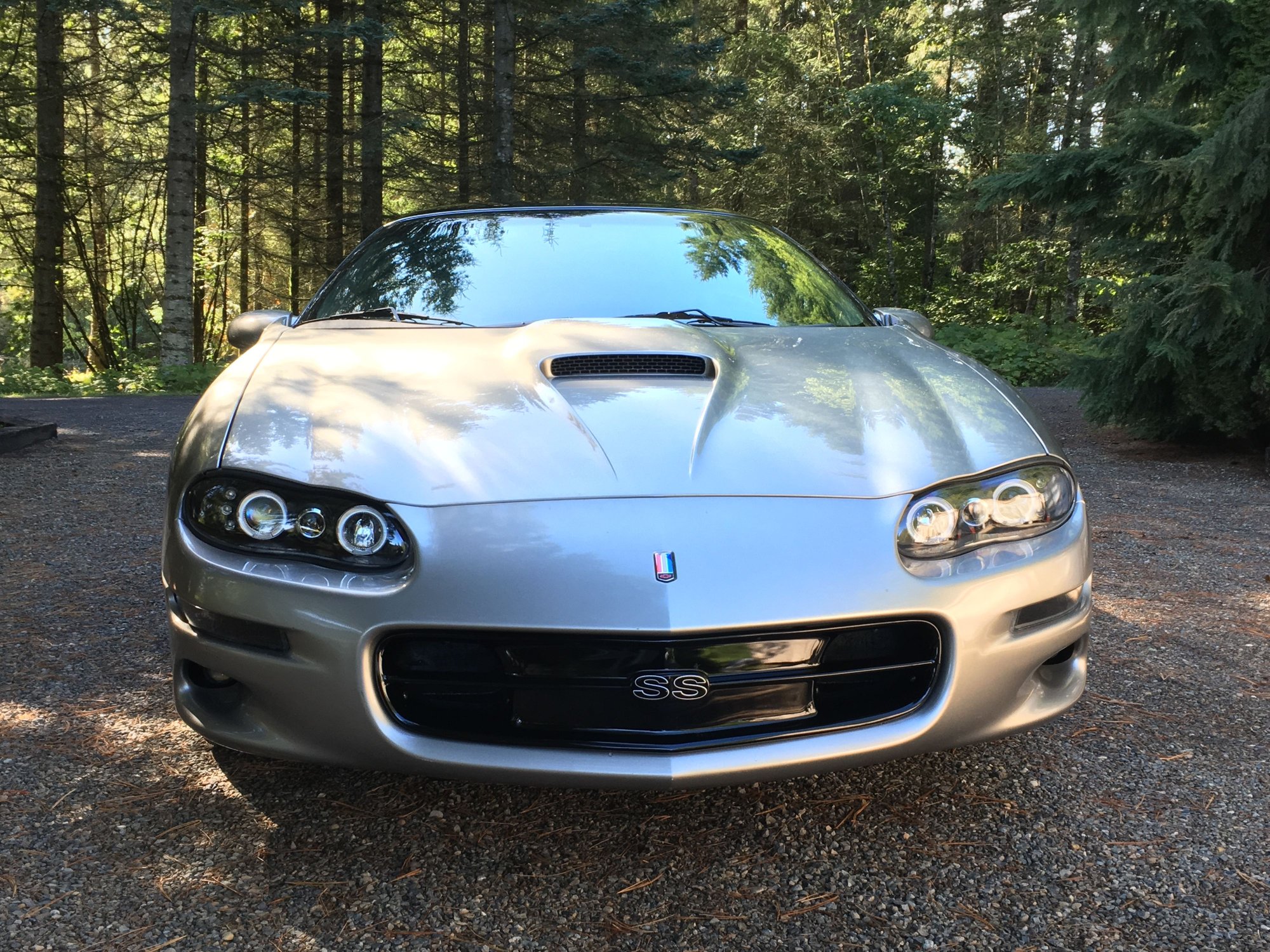

Not 100% sure but I think it's pretty much an easy swap.
That said the catfish front grows on you after a while,I had a '93 Z28 for years and later bought my '01 SS which I've learned to love as is.
I did change out all the lights,Halo projector headlights,dark tinted turn signal/running lights and dark tinted side markers and it's lowered 2".
It really changed up the look quite a bit,looks like a mean catfish now. lol
