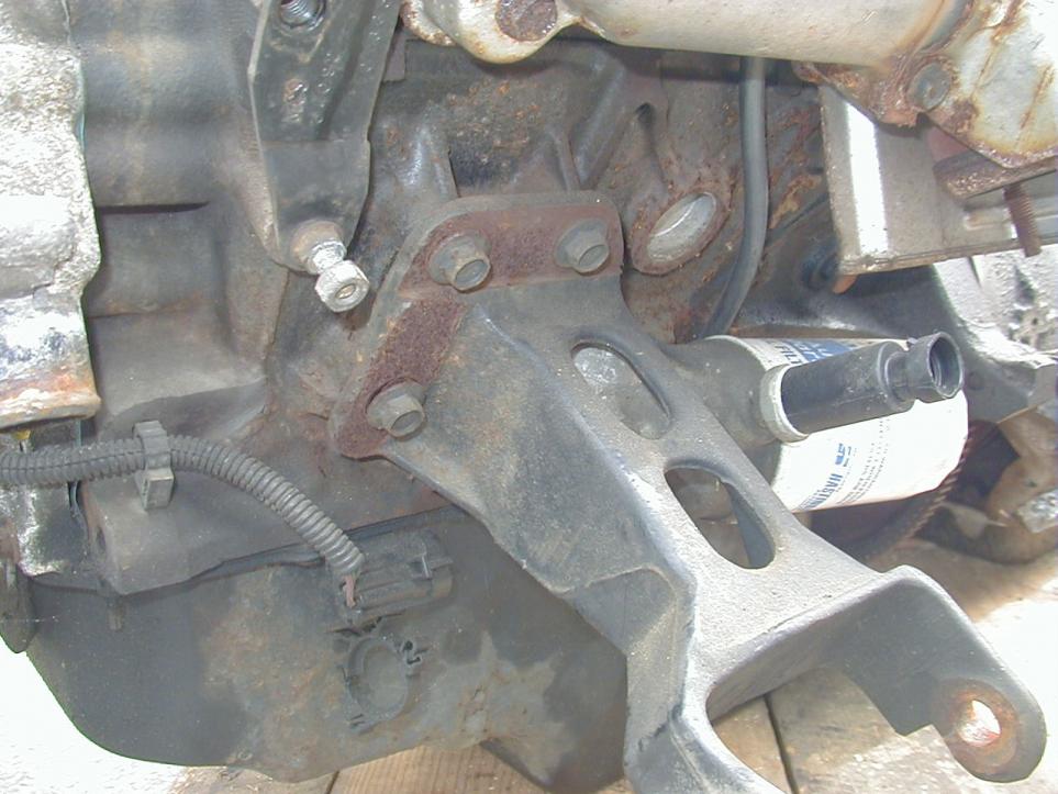

When the gauge reading changes suddenly the first thing to check/replace is the sending unit. The sending unit has a diaphragm that is exposed to oil under pressure and the diaphragm is connected to a small potentiometer (variable resistor). Because oil pressure varies constantly while you drive the potentiometer is always moving and it wears out. This potentiometer is the thing that provides the pressure info (electrically) to the gauge. Also, the diaphragm can rupture which allows oil to leak into the potentiometer part of the sender. This will change the resistance values and, therefore, gauge readings.
The oil pressure sender is a long sucker on the 3.4. It is screwed into the oil filter adapter right above the filter. After having bad luck with a few auto parts chain switches/senders I buy mine from a GM dealer. A bit more money but worth it.
