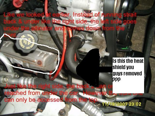

Is this the heat shield you guys are removing or have had removed prior to changing your plugs that is making everything a hell of alot easier, i don't wanna sound slow but it took me damn near three hours to change 3 and even from underneath its a P.I.T.A... and if i rip that SOB off its not really going to do anything bad right... looks like there a bolt holding it on? and man you guys were right tho i have little hands and my hands are still ripped to shreds. USE GLOVES!!!

Bump. Anyone have an answer for NeverSayDie? I'm wondering the same thing... thanks.

No it won't do anything bad.

Can someone answer his question, specifically... if the attached picture, with the highlighted area is the heat shield you guys are removing to make the job easier?
