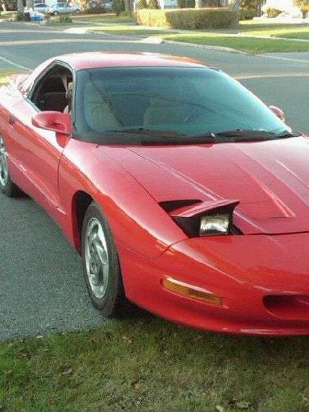

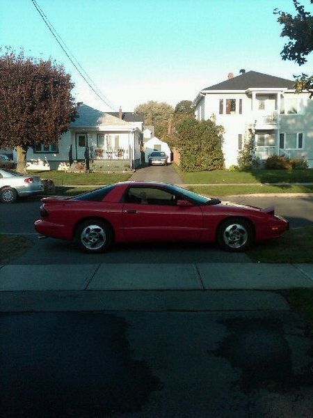

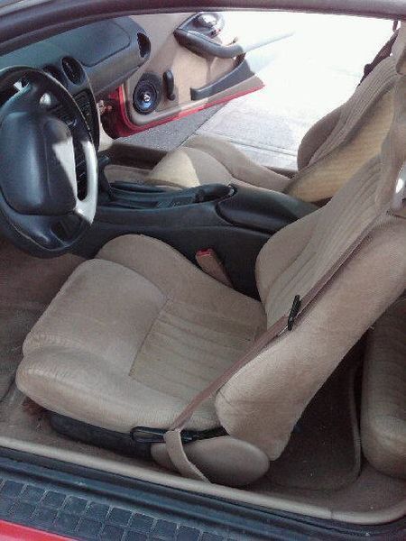

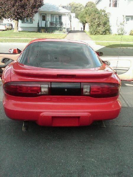

Its a Firebird lol. 1995 base model, has a 3.4L in it and i wanted to swap to a 5.0L TPI i can get. the motor came out of a 92 firebird but has no wiring harness, what have i got myself into lol. what do i need to make this happen? anyone done such a swap?
