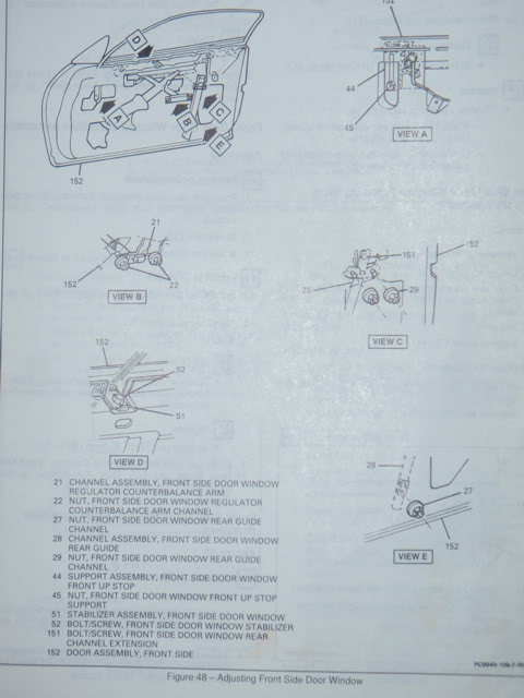

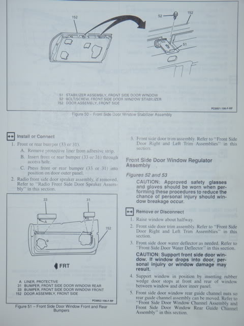

there should be pads on the stock window seal as well. also a couple bumpers down farther on a crossbar. did you put some epoxy on it before riviting. helps to hold the patch tightly in place.
