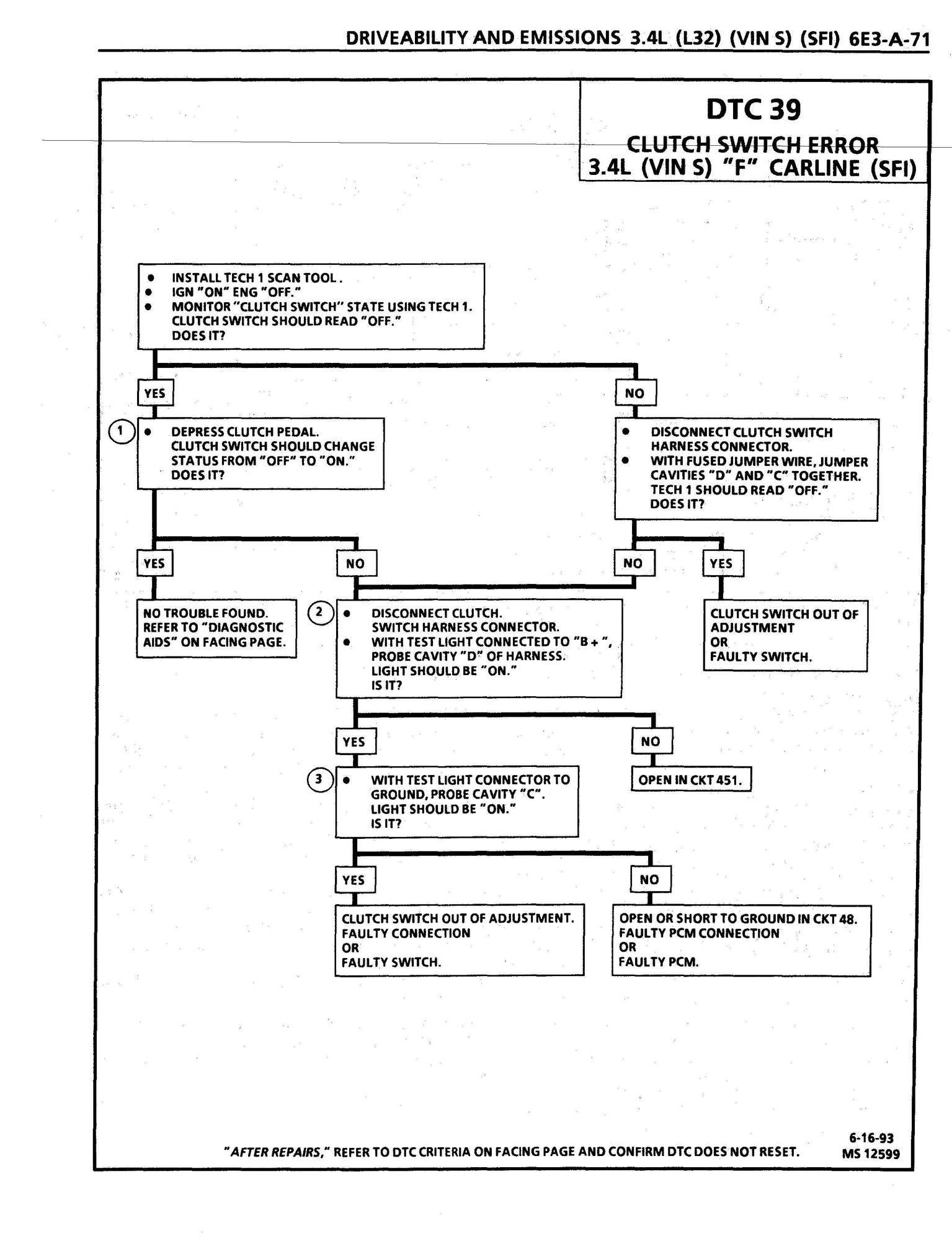

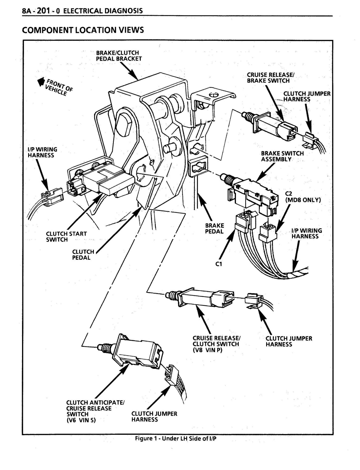

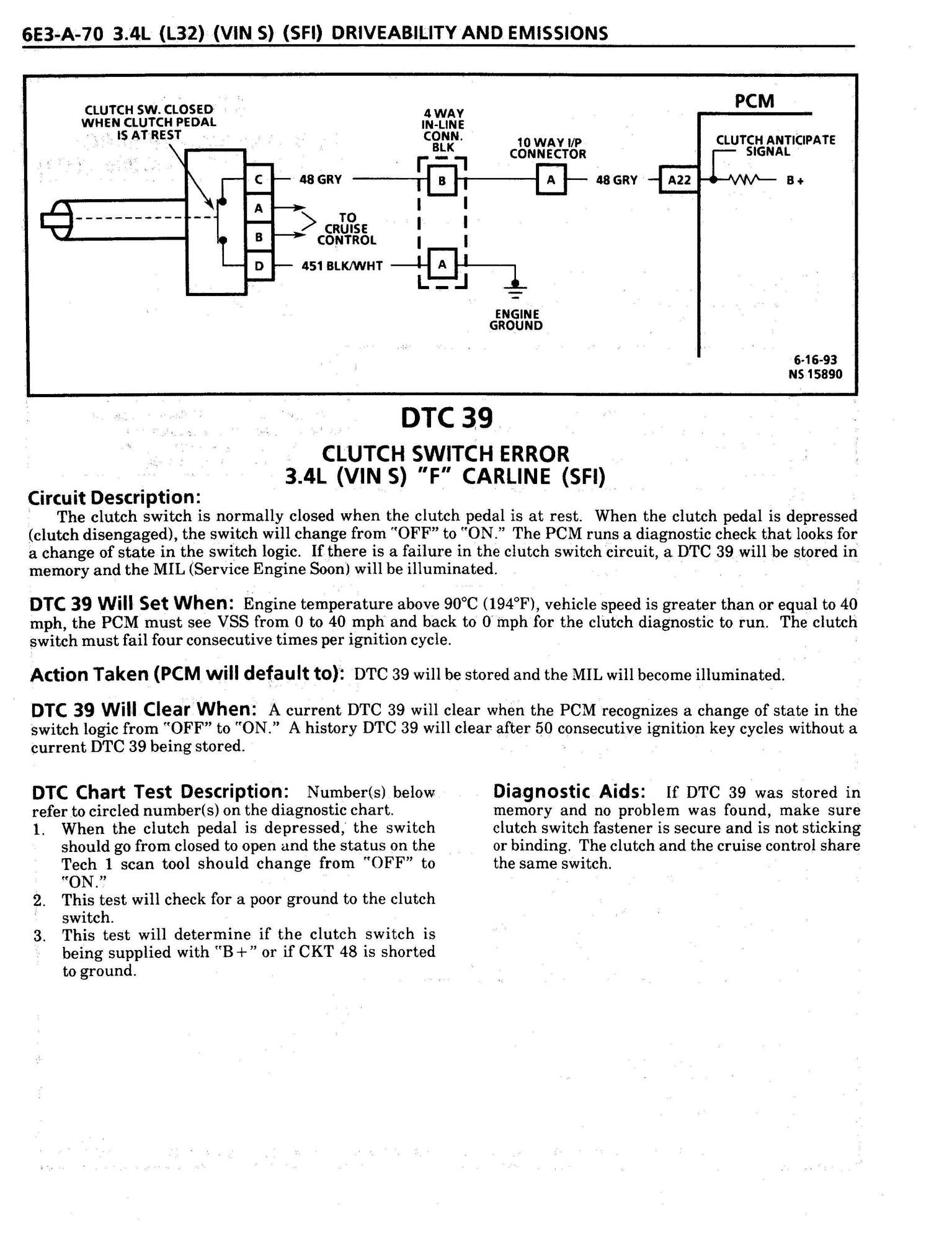

94 camaro 3.4L 5 speed tranny. 251K
My CEL randomly comes on. The light goes off if i turn the motor off and then turn it back on. Finally got an OBD1 reader. Its telling me code 39... is a defective clutch switch. Where is this switch located? Just for info, i had to pull this code after i drove home the other day without shutting the car off. If i shut the car off the code is not displayed on the reader anymore. Thank in advance.
Old Oct 17, 2020 | 01:17 AM
peterpar's Avatar
Joined: Jun 2016
Posts: 611
These are pages from the service manual that should help with locating the switch and explain the DTC code.
