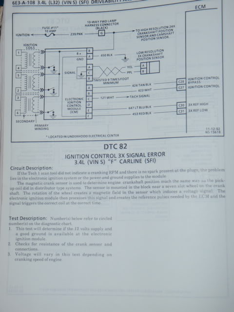

ok i also just pulled the codes on the car. it read a code 82. They said i need to replace the coils and that should fix it. does that sound accurate?

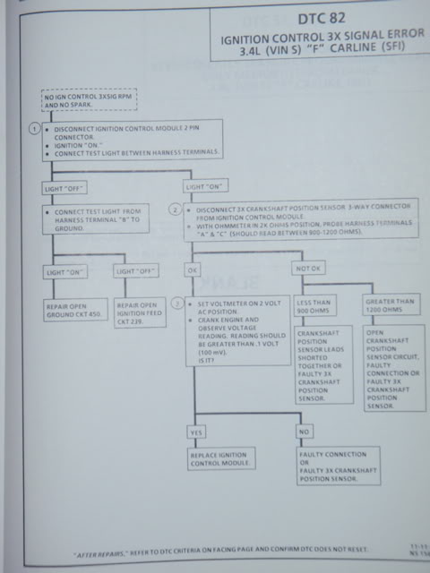

Posts: 22,042

Yeah that sounds right. I had to replace mine this summer because my 3.8 was doing the same thing. After that, it ran really smooth.
