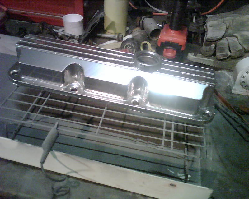

Powder coat FTW. To bad my over was not big enough for the intake

that looks amazing gorn. im going to try out the degreasser massey talked about first but how do you powercoat def something iwant to look into.

i use awesome its an industrial cleaner/degreaser you get it from the dollar store its the best cleans everything even blood from a white shirt never use the bleach white on anything but tires tho as for powdercoating just type powdercoat and the zip the the closest big city near you into google and you should find something

If the part will fit in your oven you can powder coat at home. Yes get permission from the head cook first since it is car parts in the kitchen. Usually you need a compressor and a powder gun once the powder is applied you bake it and it creates a very hard shell.

Once you use a over for powder coating it should never be used for food again.
