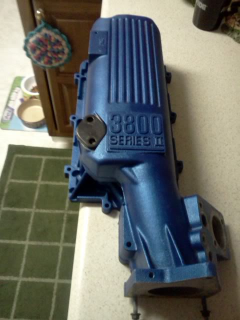

Plugs and wires could use a change. Checked oil and she looked good. I did notice what appears coolant in one of the well area's of the injectors.
Was planning on changing her uim power coated a fresh one for my wife.
