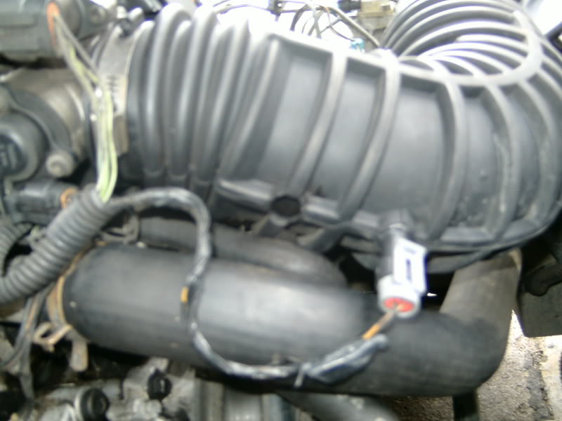

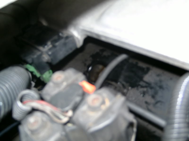

Liberty, here are a couple pictures of the holes I'm talking about, one on the intake, and the other on the valve cover.. Sorry for the bad quality on the valve cover.Name:  PICT0229.jpg

Yep, that's it. You need that long Crankcase Vent Pipe, a clip that holds it on the air intake rubber (looks like someone cutoff the protrusion on yours, so you might have to do a custom install or get another rubber intake), and rubber adapter into the valve cover. The piece going into the valve cover deteriorates with time -- I had to replace mine once, and it actually made a big difference in improving the engine behavior.
