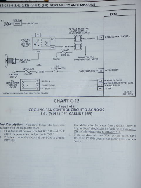

Old Jan 31, 2011 | 02:36 PM
Posts: 22,027
Size:  65.0 KBName:  PA030002.jpg
Size:  50.8 KBName:  PA030005.jpg
Old Jan 31, 2011 | 03:44 PM
Massey's Avatar
Joined: Apr 2010
Posts: 3,354
From: Spanaway, WA
Yup that is the ticket right there Craby!

Old Dec 13, 2011 | 05:36 PM
Vapor's Avatar
Joined: Dec 2011
From: Tennessee
Default 220 degrees fahrenheit
Your ECM doesn't kick in the main fan til 220 degrees fahrenheit. Thats normally 3/4 of the way to red. The only way to change that is to get another Coolant sensor on a different scale but is still close.
BTW your main fan is turned on by the ECM grounding the FAN RELAY. The ground(-) from the ECM(Green wire) tells the RELAY to turn on the fan. Then it sends power if the key is ON. the relay is energized when the key is ON but needs the ground to switch the relay.
The green wire from the ECM travels right past the battery so you can just pull it out and ground it there to always have the fan on when you have the Key to ON. Better yet you can splice into it and send a wire to the dashboard with a switch. On the other pole of that switch just attach it to ground with a screw. Then when you switch it to ON the relay will get a ground and turn on the fan and you won't have to deal with any volts so it can be a cheap switch.
